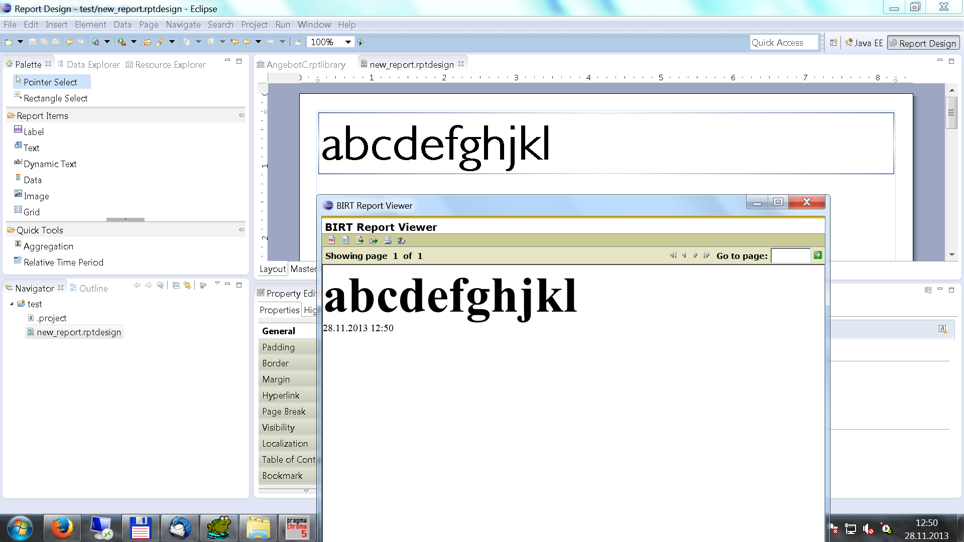

i'm playing with some new fonts. I installed them in my default windows fonts folder. The ttf-Files works very well. But some fonts are in pfm and pfb. It seems like BIRT aren't handling these fonts. On report design all is good. But after rendering it's the wrong font. The picture shows what i mean: there's the new font GillSans Light in pfm installed on windows. After rendering it looks different...
Best regards

BIRT likes TTF for PDF, at least. If you run the report to just HTML, rather than the web viewer, does it work properly?

I converted fonts into ttf and now all is fine. No, for html it wasn't working too.
