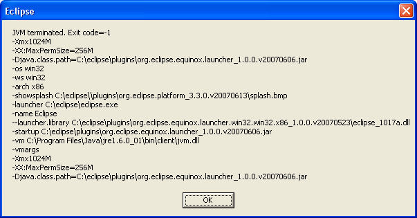

I downloaded WTP 2.0 using the wtp-all-in-one-sdk-win32. But it can not
start with the Java argument
-Xmx1024m.
More information:
1. WTP 2.0 can start with a smaller maximum heap, e.g., -Xmx768m.
2. My other Java program, e.g., Tomcat, can start up with -Xmx1024m.
3. There is no error message in .log file.
4. I am using jdk 1.6.0_01.
Has anyone also met this?
Thanks in advance!
Weijian

On Tue, 24 Jul 2007 14:23:25 -0400, Weijian <wjfang@gmail.com> wrote:
>> What's the full command line you're using to start it? Have you
> C:\eclipse\eclipse.exe -vmargs -Xmx1024M -XX:MaxPermSize=3D256M
What physical memory do you have on your machine? I did a little experim=
ent,
and I confirmed your command line worked on my machine, but then I kept =
increasing max heap,
and found if it got large enough then I'd see the same VM startup error.=
In my case,
I have 2G of memory on my machine, so sort of makes sense my machine mig=
ht handle 1G, but not 1.5G or 2G.
So ... if you only have 1G, or 1.5? then that might explain it.

Originally posted by: wjfang.gmail.com
I also got 2G physical memory.
And you see on my computer Tomcat can run with "-Xmx1024m" with no problem.
So the JVM is happy with "-Xmx1024m". It seems it is Eclipse that is not
happy with it. Does eclipse have its own memory management system, which
does some analysis on start-up and somehow goes to a conclusion that
"-Xmx1024m" is not a proper setting on my computer?

What physical memory do you have on your machine? I did a little experiment,
and found if it got large enough then I'd see the same VM startup error. In
my case,
I have 2G of memory on my machine, so sort of makes sense my machine might
> And you see on my computer Tomcat can run with "-Xmx1024m" with no pro=
blem.
> So the JVM is happy with "-Xmx1024m". It seems it is Eclipse that is n=
ot
> happy with it. Does eclipse have its own memory management system, whi=
ch
Yes, probably ... but, is probably still a bug, and could ask on platorm=
newsgroup as
Konstantin suggests (or open a bug, if you can demononstrate "raw" java =
command works, but
eclipse.exe does not).
I peeked in some of the launcher code, and saw
static void adjustVMArgs( _TCHAR *vm, _TCHAR **vmArgv[] ) {
/* Sun VMs need some extra perm gen space */
if (isSunVM(vm) && permGen !=3D NULL) {
And, that was all the C code I wanted to read :)
