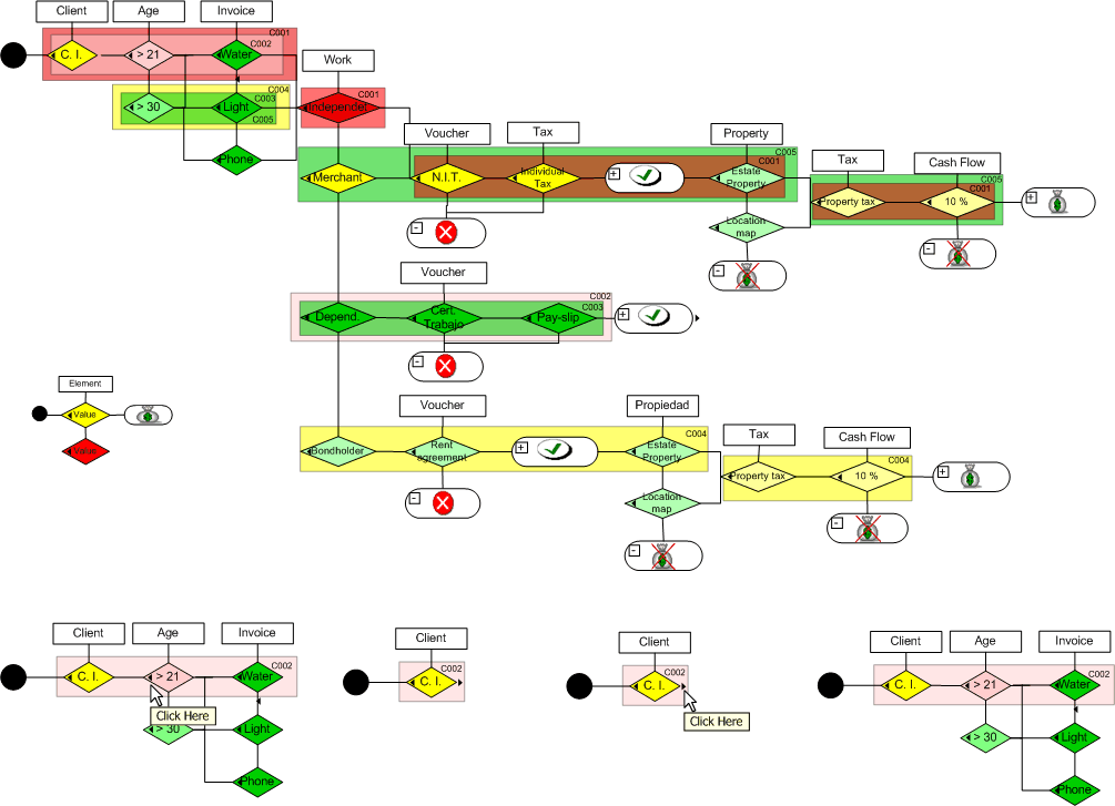

We want to represent in GEF, a workflow, but we have some doubts about witch
layout is the most advisable for this case (attached file).
We don't have isues with the figures, and lines, but when u add a new figure
to the Editor, it must be placed next to the other, or if the situation
requires it underneath, but the figures always must be aligned with respect
to the father or the brother.
if somebody has some idea about wich layout we should use please answer us,
and tell us where we can see documentation of the layout.

There is a "tree" example in CVS in the org.eclipse.draw2d.examples project.
See the FAQ for how to load that project.
This type of layout is similar to an org chart. It is something that we have
been wanting to add to Draw2d for a few releases, but we haven't had enough
help from the community to define the problem.

Thanks for the answer, i already download the draw2d.example, but i can't
find the FAQ of the example, could u tell me where to look for it?
Thanks!!

The FAQ is off our homepage. The draw2d.example package is not part of the
downloads, which is why you must get it from CVS.
