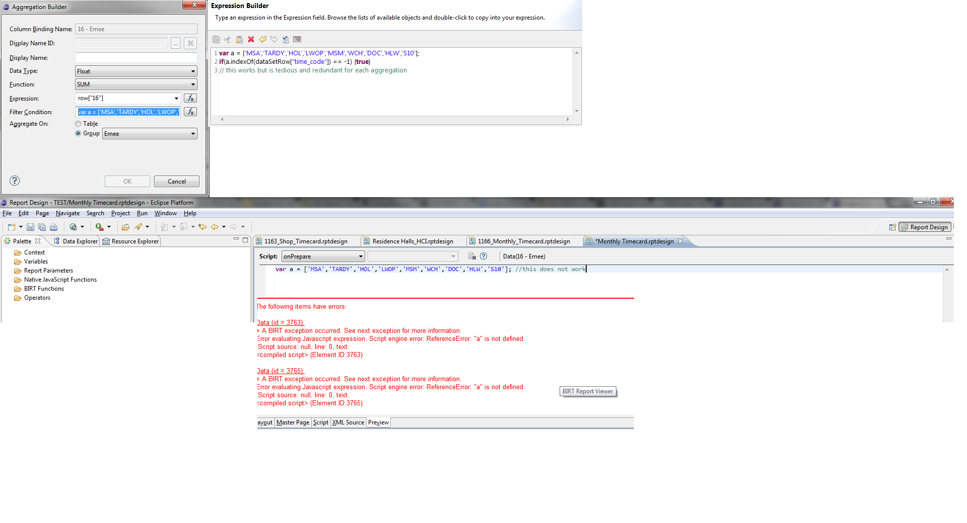

I am attempting to define a variable that will be used in multiple aggregations under the filter expression. The variable is always the exact same array:
a = ['HOL','HLW','HLA']
I can definite the variable in each individual aggregation, but this seems tedious and could be a little inconvenient if they ever needed to be updated. So I've been attempting to define the variable in one single location, but I keep receiving a "variable a is not defined" error when I attempt generate the report.
I've tried putting it in the entire row (group footer) using the script tab on both onPrepare and onCreate, but without success. I also tried defining it in the detail rows as Dynamic Text. Lastly, I tried entering it in the "Named Expressions" property for the entire chart. None of these have resolved the error.
My question is, where do I define the variable so that it can be used in the group aggregations?

There is a "Variables" section in the outline view where we can define such global elements.
As you can see on your second screen there is a "Variables" element in the palette.
For example:
- Create a new variable named "myListFilter"
- Set the list of values in the "default value" property,
- We can access it from any place in the report with the expression
vars[myListFilter]
Furthermore, these variables can be graphically dragged in the expression builder of any BIRT element, which is very convenient.
By the way, i believe "indexOf" is a method for Strings but not for Arrays, don't use brackets. Just in case with an array:
vars["myListFilter"].join(',').indexOf('HLW');

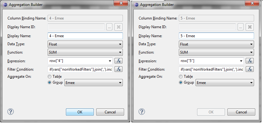

Followup question, is there a way to automate the process of building groups that are similar, but that use a different datasetrow for their expression?
Example:
index.php/fa/16812/0/
I have to build an aggregation for each day but they are all similar, the only thing that changes is the data field - which is the day of the month #. I've had limited luck with concatenating the source code in Excel and then pasting it into the XML and am concerned about corrupting the report.
