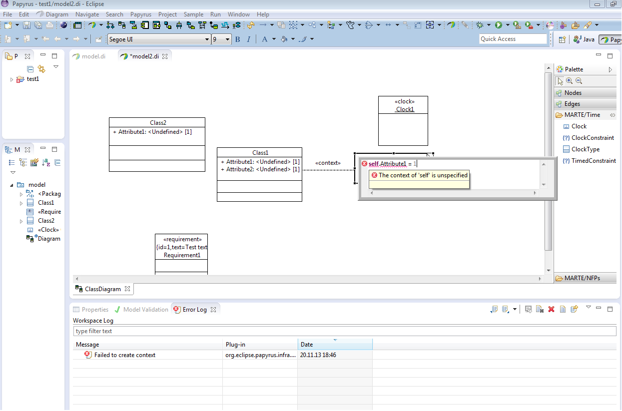

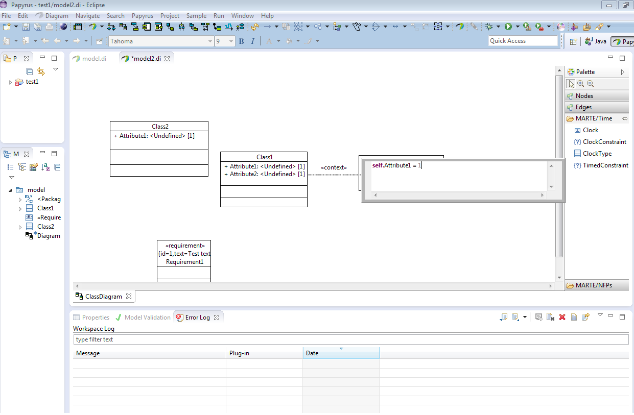

I may be doing something wrong, but I wanted to use OCL and the text editor brakes as soon as I add a MARTE <<clock>> or a SysML <<satisfy>> for example. I made sure I added the context from the properties and even with a context link edge. Can someone please enlighten me, am I doing something wrong or is this a bug?
index.php/fa/16793/0/
index.php/fa/16794/0/
Thank you for your time,
Damjan

Your picture shows an entry in the Error Log.
What is the stack trace?

Re: MARTE and SysML stereotypes brake OCL text editor [message #1203159 is a reply to message #1202471] Fri, 22 November 2013 09:09 Go to previous messageGo to next message
Sorry for not posting the stack trace. Here it is:
org.eclipse.core.commands.ExecutionException: Failed to create context for org.eclipse.uml2.uml.internal.impl.ConstraintImpl@bb4701 (name: PedalPressureActuatorMode3ReactionConstraint, visibility: <unset>)

Caused by: org.eclipse.ocl.examples.pivot.ParserException: Failed to load 'pivot:/platform/resource/uml/model.uml' : null
	at org.eclipse.ocl.examples.pivot.uml.UML2Pivot$Outer.getPivotRoot(UML2Pivot.java:548)
	at org.eclipse.ocl.examples.pivot.uml.UML2Pivot$Factory.getPivotOf(UML2Pivot.java:126)
	at org.eclipse.ocl.examples.pivot.manager.MetaModelManager.getPivotOf(MetaModelManager.java:1911)
	at org.eclipse.ocl.examples.pivot.utilities.PivotUtil.setParserContext(PivotUtil.java:1272)
	at org.eclipse.papyrus.uml.textedit.constraintwithessentialocl.xtext.EssentialOCLPopupEditorConfiguration$Reconciler.configureResource(EssentialOCLPopupEditorConfiguration.java:71)
	... 67 more
Caused by: java.lang.NullPointerException
	at org.eclipse.ocl.examples.pivot.uml.UML2Pivot$Outer.installStereotypes(UML2Pivot.java:766)
	at org.eclipse.ocl.examples.pivot.uml.UML2Pivot$Outer.getPivotRoot(UML2Pivot.java:538)
	... 71 more
