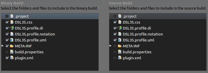

Re: Adding a Profile to a Plugin [message #1404784 is a reply to message #1194167] Tue, 05 August 2014 14:02 Go to previous messageGo to next message
Hi Camille, thank you for the swift reply.
Below goes a screen capture of my build.properties file as portrayed by the GUI. I have all the Papyrus files selected, as so the CSS.
index.php/fa/18786/0/
Thank you.
Re: Adding a Profile to a Plugin [message #1405412 is a reply to message #1404784] Thu, 07 August 2014 05:46 Go to previous messageGo to next message
Use the code below and put all your DSL3S files into the directory "MyPluginName/resources/DSL3S" like:
MyPluginName/resources/DSL3S/DSL3S.profile.di
MyPluginName/resources/DSL3S/DSL3S.profile.profile.notation
MyPluginName/resources/DSL3S/DSL3S.profile.profile.uml
MyPluginName/resources/DSL3S/DSL3S.css
(I personally put my papyrus project inside resources)
   <extension
         point="org.eclipse.emf.ecore.uri_mapping">
      <mapping
            source="pathmap://resources/DSL3S/"
            target="platform:/plugin/MyPluginName/resources/DSL3S/">
      </mapping>
   </extension>
   <extension
         point="org.eclipse.papyrus.uml.extensionpoints.UMLProfile">
      <profile
            description="UML profile DSL3S"
            name="DSL3S"
            path="pathmap://resources/DSL3S/DSL3S.profile.uml"
            provider="My friend Luis">
      </profile>
   </extension>
Ensure that you have selected all the resources necessary for your profile in the build.properties.
It should work with that otherwise you missed something.

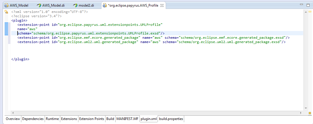

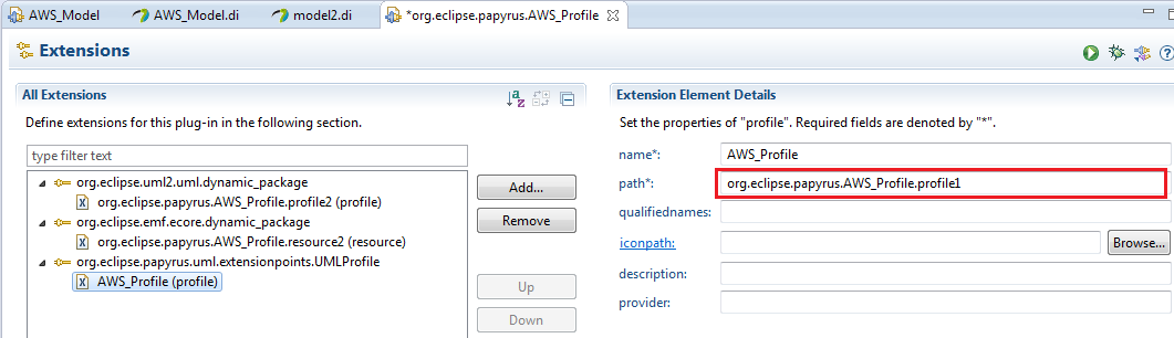

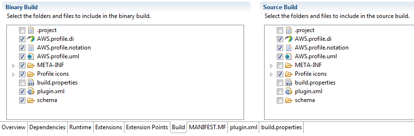

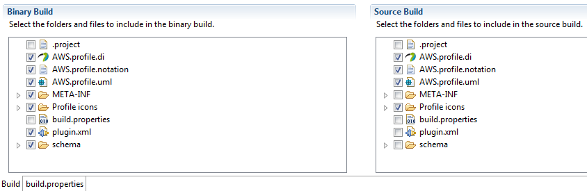

Re: Adding a Profile to a Plugin [message #1424914 is a reply to message #1405781] Tue, 16 September 2014 11:44 Go to previous messageGo to next message
Hi all,
I followed all the steps but I couldn't register my profile Sad
This is what I did:
- I converted the project that contains the profile (Papyrus project) into Plugin project.
- I added these extension points:
- org.eclipse.emf.ecore.generated_package
- org.eclipse.uml2.uml.generated_package
- org.eclipse.papyrus.uml.extensionpoints.UMLProfile
(I just filled the name of the extension point, in my case "aws")
- I selected files and folders in build.properties
- I exported the plugin then I installed it.
But when I created a new Paypyrus model and cliked on "apply registerd profile", I didn't find my profile in the list Crying or Very Sad
Please help me, what should I do??
  • Attachment: tof1.png
    (Size: 26.36KB, Downloaded 424 times)
  • Attachment: tof2.png
    (Size: 18.30KB, Downloaded 420 times)
  • Attachment: tof3.png
    (Size: 56.20KB, Downloaded 407 times)

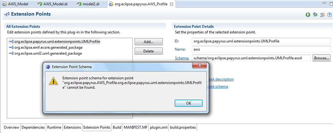

Re: Adding a Profile to a Plugin [message #1424921 is a reply to message #1424914] Tue, 16 September 2014 11:50 Go to previous messageGo to next message
Hi Walid,
You need to use the "Extension" tab (i.e. contribution), not the "Extension point" tab (i.e. declaration)
Camille

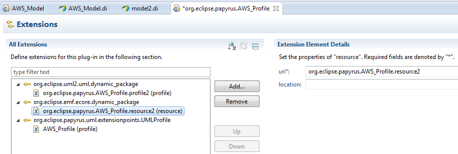

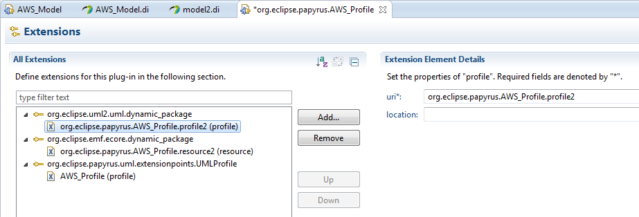

Re: Adding a Profile to a Plugin [message #1424953 is a reply to message #1424937] Tue, 16 September 2014 12:57 Go to previous messageGo to next message
You will need dependencies to the UML, EMF and Papyrus plug-ins which define these extension points. The simplest way is, when adding a new extension, to uncheck "Show only extension points from the required plug-ins". Eclipse will show you all avaible extension points, and will automatically add the required dependencies afterwards.
The required dependencies are:
Camille

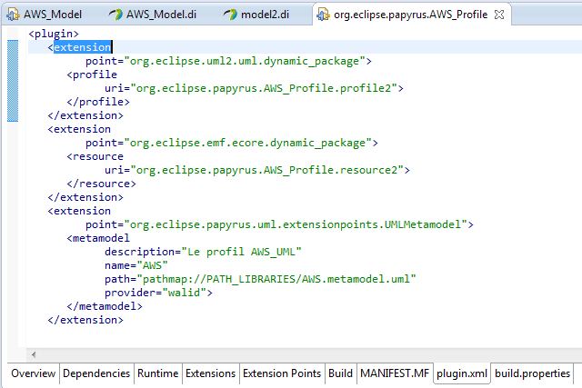

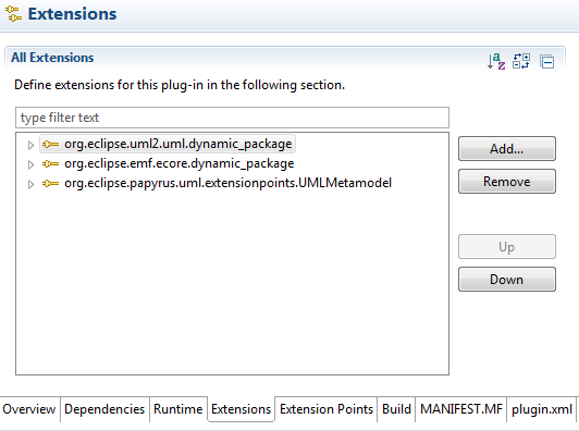

Re: Adding a Profile to a Plugin [message #1424981 is a reply to message #1424953] Tue, 16 September 2014 13:48 Go to previous messageGo to next message
Thank you again..
I didn't find this extension point: org.eclipse.papyrus.uml.extensionpoints.UMLProfile
I found that: org.eclipse.papyrus.uml.extensionpoints.UMLMetamodel
I don't know if they are the same thing or not? but i added it.
Then, I installed the plugin, created a new papyrus model, tried to apply my profile, but i didn't find it in registered profiles Confused
I don't know where is the problem? is it the build.properties or is what i did in the first step is wrong? (converting a papyrus project that contains the profile to plugin project)
I did right click-->configure-->convert to plugin projects
is there a better soution to bundle the profile into a plugin?
  • Attachment: tof5.png
    (Size: 15.55KB, Downloaded 384 times)
  • Attachment: tof6.png
    (Size: 22.72KB, Downloaded 360 times)
  • Attachment: tof7.png
    (Size: 20.05KB, Downloaded 349 times)
Re: Adding a Profile to a Plugin [message #1425128 is a reply to message #1424981] Tue, 16 September 2014 18:47 Go to previous messageGo to next message
I'm sorry for my last message, maybe I didn't pay attention but I found the extension point "org.eclipse.papyrus.uml.extensionpoints.UMLProfile"
I finally found my profile among registered profiles, but the problem is when I click on it and validate, nothing happens! The window "Choose profile to apply" where I must check my profile didn't appear!! I have a doubt about the attribute "path" of "org.eclipse.papyrus.uml.extensionpoints.UMLProfile" extension point.
Please, what should I put to fill these extension points??
  • Attachment: path.png
    (Size: 29.48KB, Downloaded 402 times)
  • Attachment: URI1.png
    (Size: 24.61KB, Downloaded 349 times)
  • Attachment: URI2.png
    (Size: 24.41KB, Downloaded 409 times)
Re: Adding a Profile to a Plugin [message #1425380 is a reply to message #1425128] Wed, 17 September 2014 04:16 Go to previous messageGo to next message
The path should be a valid EMF URI indicating the location of the UML Profile file:
platform:/plugin/<pluginID>/path/to/the/profile.uml
e.g.:
platform:/plugin/org.eclipse.papyrus.sysml/model/SysML.profile.uml
Camille
Re: Adding a Profile to a Plugin [message #1425398 is a reply to message #1425380] Wed, 17 September 2014 04:51 Go to previous messageGo to next message
Thank you so much for your advices!! Finally it worked!
here's the path I put: platform:/plugin/org.eclipse.papyrus.AWS_Profile/aws.profile.uml
Best regards

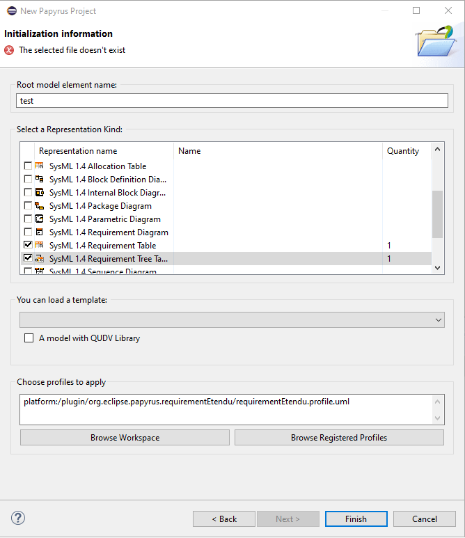

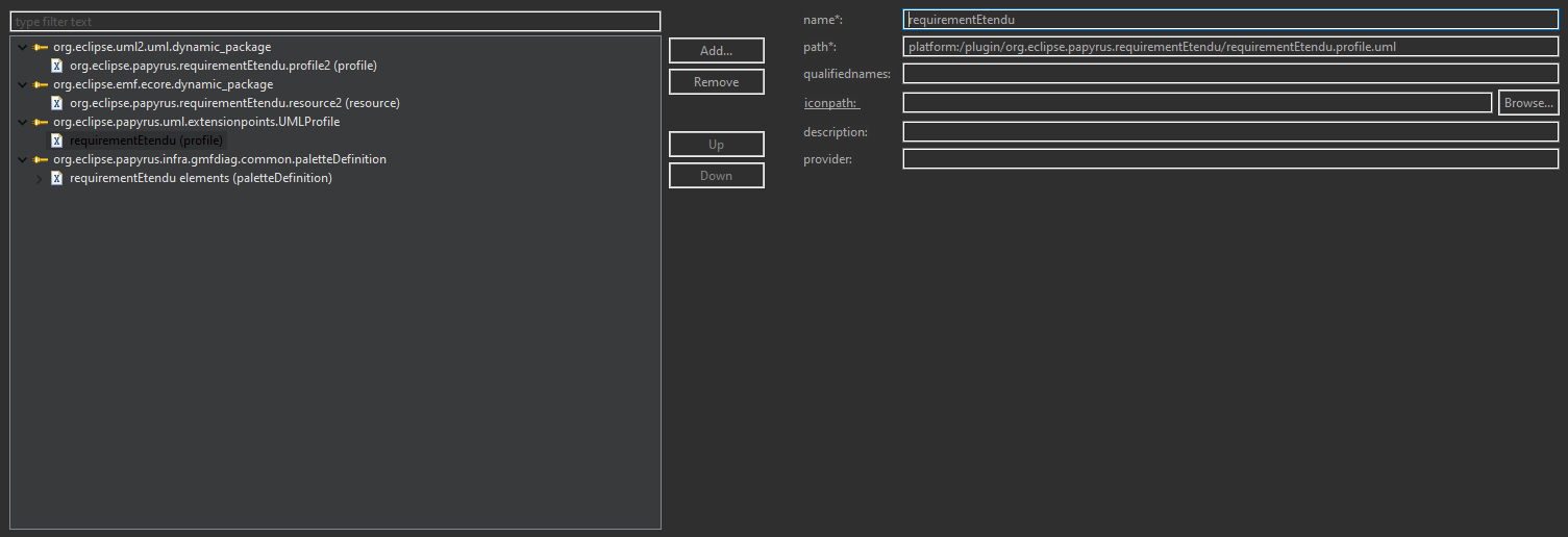

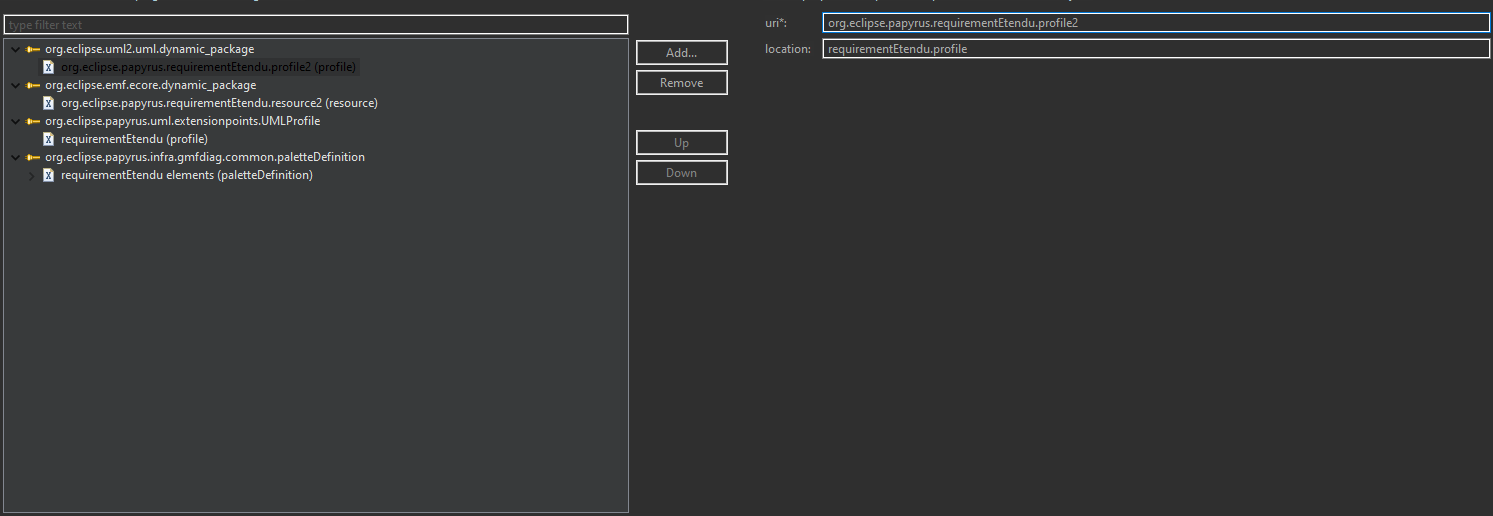

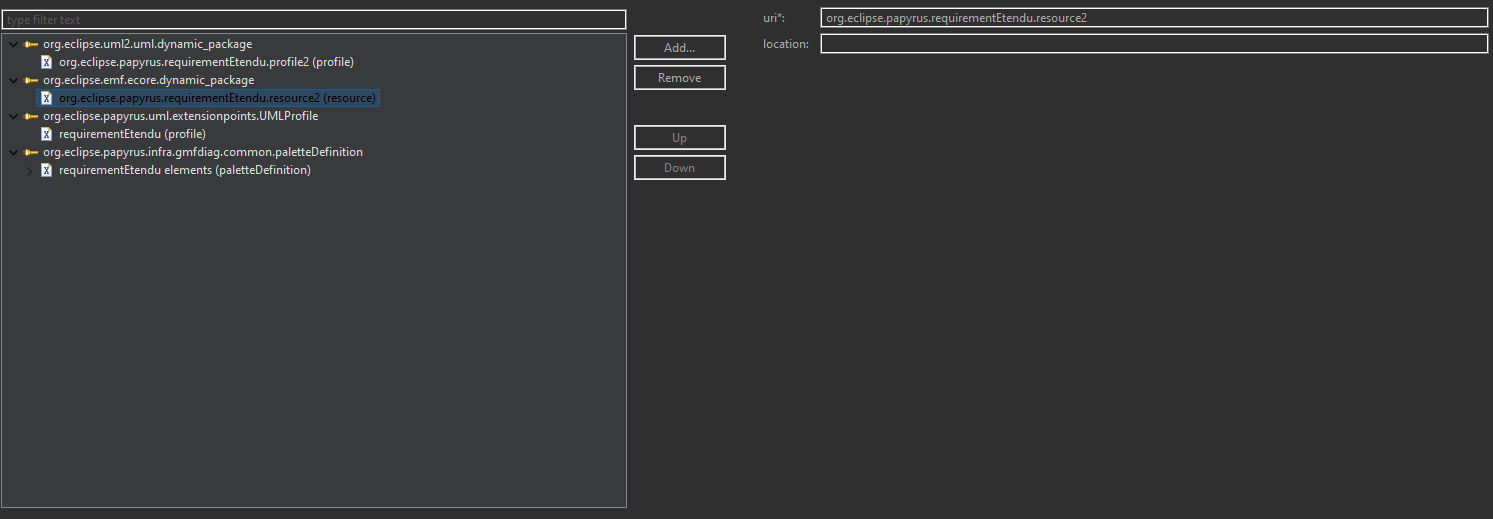

Re: Adding a Profile to a Plugin [message #1828266 is a reply to message #1194167] Fri, 05 June 2020 04:51 Go to previous message
I made a sysml 1.4 profile that i want to add in a plugin.
I followed the steps presented on this topic, but when I try to select my profile in the plugin the message "The selected file doesn't exist" appears.
I think the problem comes from the extensions but i can't tell where
Thank you in advance.
