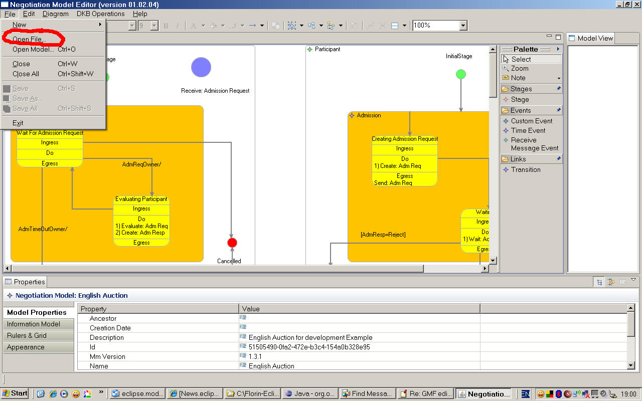

Hi all,
I have some questions. I made a GMF editor and I want to understand/manage
the menu. More precisely, the generator produces some "extra menu items"
which I can not see in the "extensions" section of the "plugin.xml". For
example the "Diagram" menu which only shows up when a diagram is open into
the editor. BUT, there is no "org.eclipse.ui.editorActions" extension
declared into the plugin.xml... Where does it come from???
Second, there is a menu item "Open File..." into the "New" menu. Also for
this one I can not find anything into the "plugin.xml". Where does it come
from??? (I want to remove it)
Third, in the "Help" menu, there is the "Software updates" sub-menu which I
would like to manage, but, again, I can not say where is it coming from,
so...
Please, help me with this. Thanks,
Floppy

Hello FLORIN,
> section of the "plugin.xml". For example the "Diagram" menu which only
I think this menu came from org.eclipse.gmf.runtime.diagram.ui.providers
plugin.
It looks like a standatd Eclipse menues. If you'd like to remove it try working
in RCP mode.
Same with this - eclipse standard menu..
Alex Shatalin
Re: GMF editor menu [message #188041 is a reply to message #188034] Tue, 20 May 2008 12:03 Go to previous messageGo to next message
Originally posted by: fbanica.soluta.net
Thanks for your answer, Alex.
I am in RCP. My application is an RCP... See the attachments, please...
Other hints?
