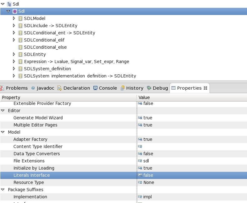

In the generated *.genmodel file, the default value of "Literals Interface" (EPackage --> Model) is "false" (Please see the attached screen-shot). However, I need to use the literals in my customization code. So I have to manually set the value to "true" and re-generate the Model code (it is not convenient for me).
So, my question is: could I make the default value to be "true' when running the MWE2 workflow? Do I need extra configuration in the *.mwe2 file? Thanks in advance!

You should switch to an imported metamodel in the grammar and maintain
the ecore stuff manually.
