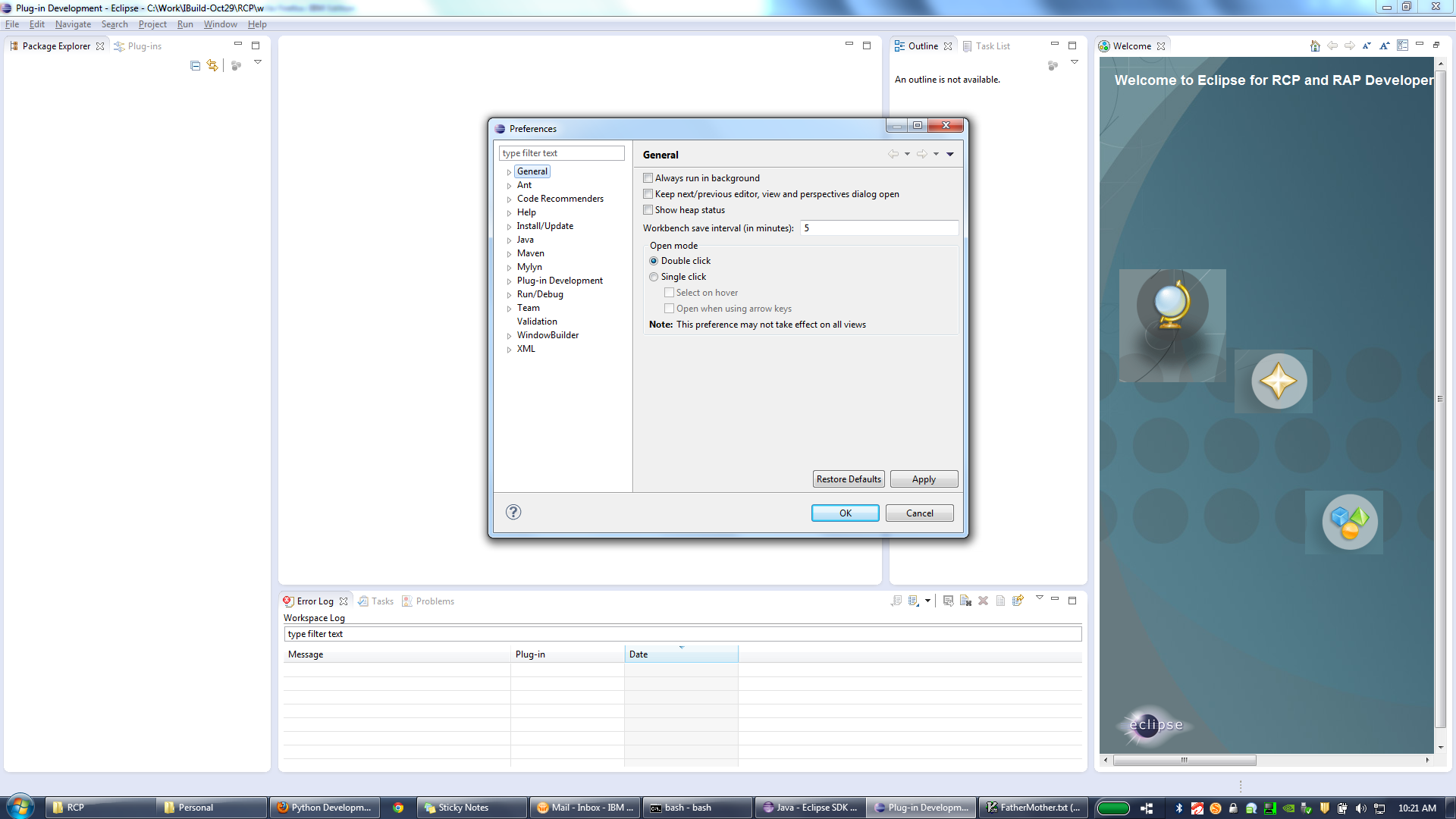

I have python 2.7 installed. The issue is as described in 2.3 you type Windows->Preferences and then Pydev menu should show up.
I do not see it.

Re: Java Exception [message #1199027 is a reply to message #1174417] Wed, 20 November 2013 11:41 Go to previous messageGo to next message
Hi, sorry by the late. You need install Pydev plugin --> http://pydev.org/
Use the eclipse marketplace or install new software to install it.
Once time done this, the option Pydev will be appear in Preferences window.
Regards.
