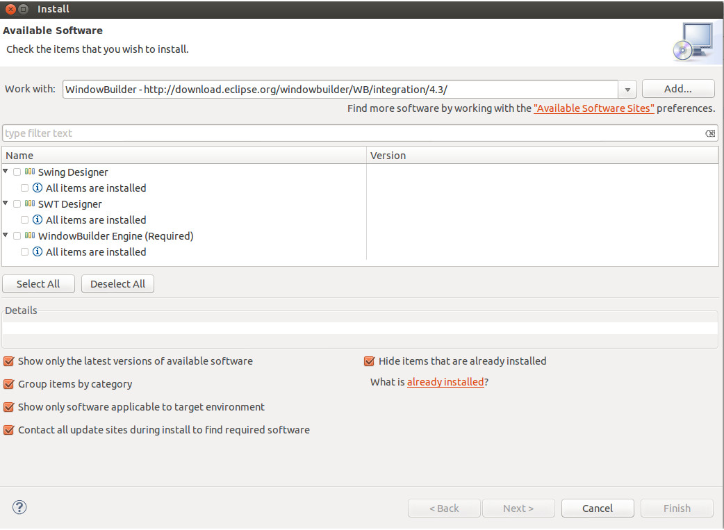

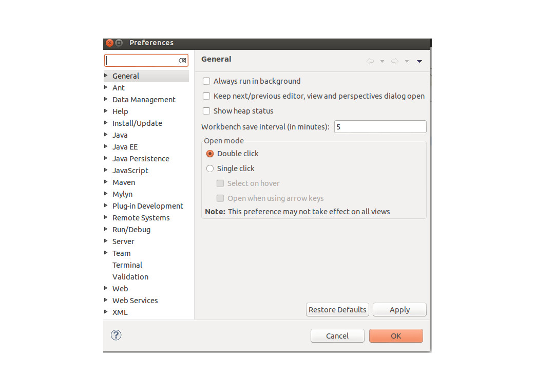

Hi ,
Why i said its installed successfully becasuse when i try to install it again its showing like already installed. I am uploading some screenshots here for more clarification.

Re: Window Builder [message #1164360 is a reply to message #1162078] Thu, 31 October 2013 12:23 Go to previous messageGo to next message
It works just fine when I install into Eclipse 4.3.1.
I would suggest installing again into a clean copy of Eclipse Standard 4.3.1 with a clean workspace.
You can also upload your "Help > About > Installation Details > Configuration". That might point to whatever the problem is with your specific Eclipse environment.

Hi Eric
Thanks for the info.I reinstall the plugin from configuration and its work great.. Really thanks for the valuable info.
