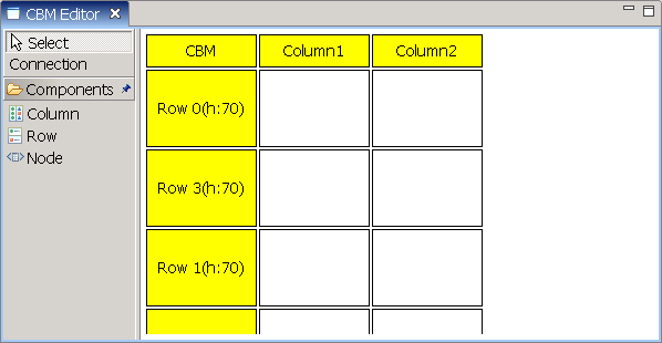

Hi all,
I am developing a table-like application, there are 3 types of figures:
Table, Column, and Cell. Table and Column are using ToolbarLayout as
layout manager, the Table figure is in fact the diagram, I can dynamically
add some cells into the column. Now I have some problem about the Column
figure's size.
I want Column figure's height to be the sum of its children(Cells).
Currently, I give every cell figure a minimumSize and a preferredSize,
they are same value, and I refresh column's preferredSize to (100,-1),
which works quite well, because I think the minimum size of cells prevent
column to be too small. But when the columns get higher, the editor does
not show a vertical scroll bar, unless I set column's preferredSize to
some taller value.
I failed to trace how they work, because so many calls occured, and
sometimes they call each other, I am totally confused.
I don't understand the relationship between preferredSize and minimumSize
well, seems like the sizes are cached? When should I call
setPreferredSize() or setMinimumSize() to change child/container's size,
and when should I override them in my figure, and when should I implement
a custom layout?
And, What are the complete factors determing any figure's final bound?
Such as its layout's getPreferredSize(), getMinimumSize(), and what else?
Sincerely
Hao
Re: ToolbarLayout Problem [message #181281 is a reply to message #181207] Fri, 13 May 2005 10:46 Go to previous message
This screenshot may help to describe my problem.
I expect a vertical scrollbar on the right side of editor.
