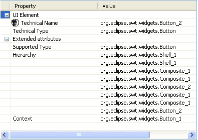

I'm having a similar issue, collecting the Next button on a wizard, in different moments I collect the button as a dialog.button.next, and in another moment I collect it as Button Component("Next>").
Attached are the properties of the 'conflicting' technical names properties for the same same button.

Are you getting component not found errors when you run the test? If not, then it shouldn't be a problem - the object mapping is heuristic, so it can deal with deviations and still find the correct component. If you are getting component not found errors, then the differences are apparently too large to count as the same component. In your example Alejo, it looks like we're able to get an ID for one of the instances, but not for the other.
If specific components are behaving like this, then you might want to use the setData() method (described in the documentation in the "Toolkits" section and then in the RCP subsection) to name the component.
