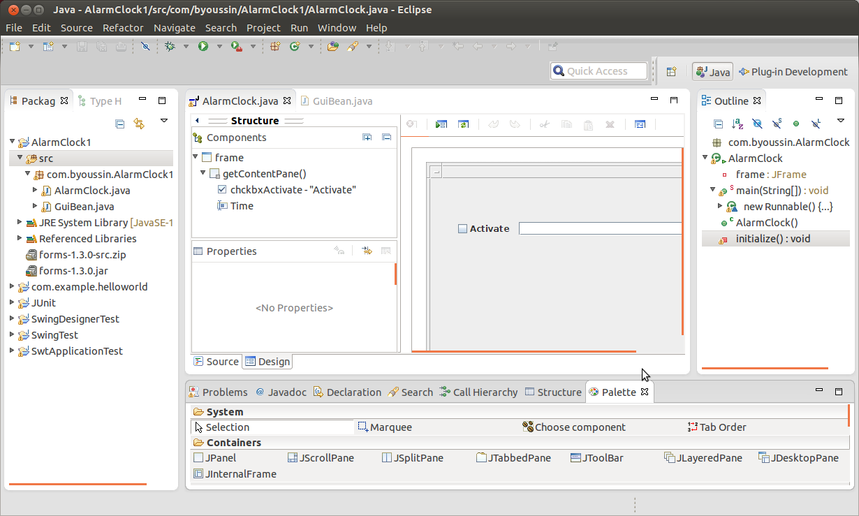

Bindings tab does not show up in my SWT project; I have only Source and Design tabs as in https://developers.google.com/java-dev-tools/wbpro/features/editing_existing_window
Various posts I have found, suggest adding bindings JARs to the project.
I have added all JARs I have found relevant, see the picture.
What am I missing?

index.php/fa/16548/0/
Here is the screenshot.
And I forgot to mention that I am running Kepler, updated yesterday, on Ubuntu 12.04.
I also installed on it everything I have found possibly relevant.
What else would you like to see?

This appears to be a Swing UI and not an SWT UI.
If you want to do Swing Data Binding, you need to add the Swing Data Binding jars rather than the SWT Data Binding jars that you have added. Alternatively, you could create an SWT UI and use the SWT Data Binding jars already added to the project.
Re: Bindings tab does not show up [message #1157833 is a reply to message #1156445] Sun, 27 October 2013 09:55 Go to previous message
Many thanks! I guess I have made some mistake and created a Swing project instead of SWT, without noticing it. I tried again and it worked out!
This issue is fully resolved!
