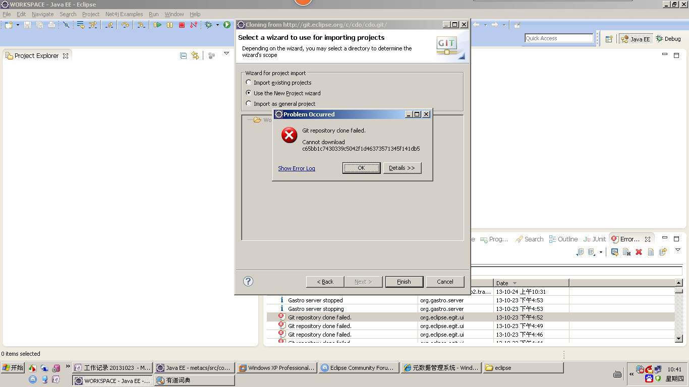

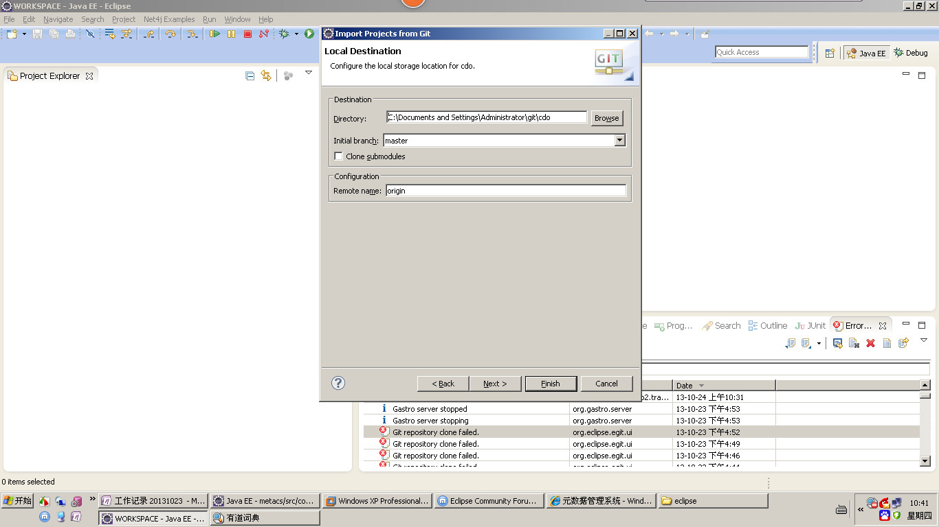

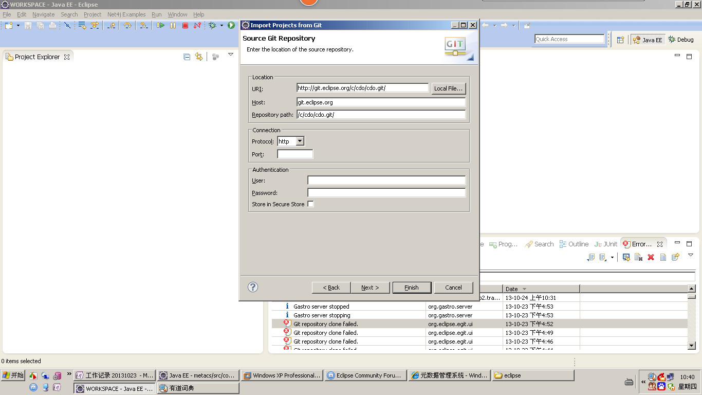

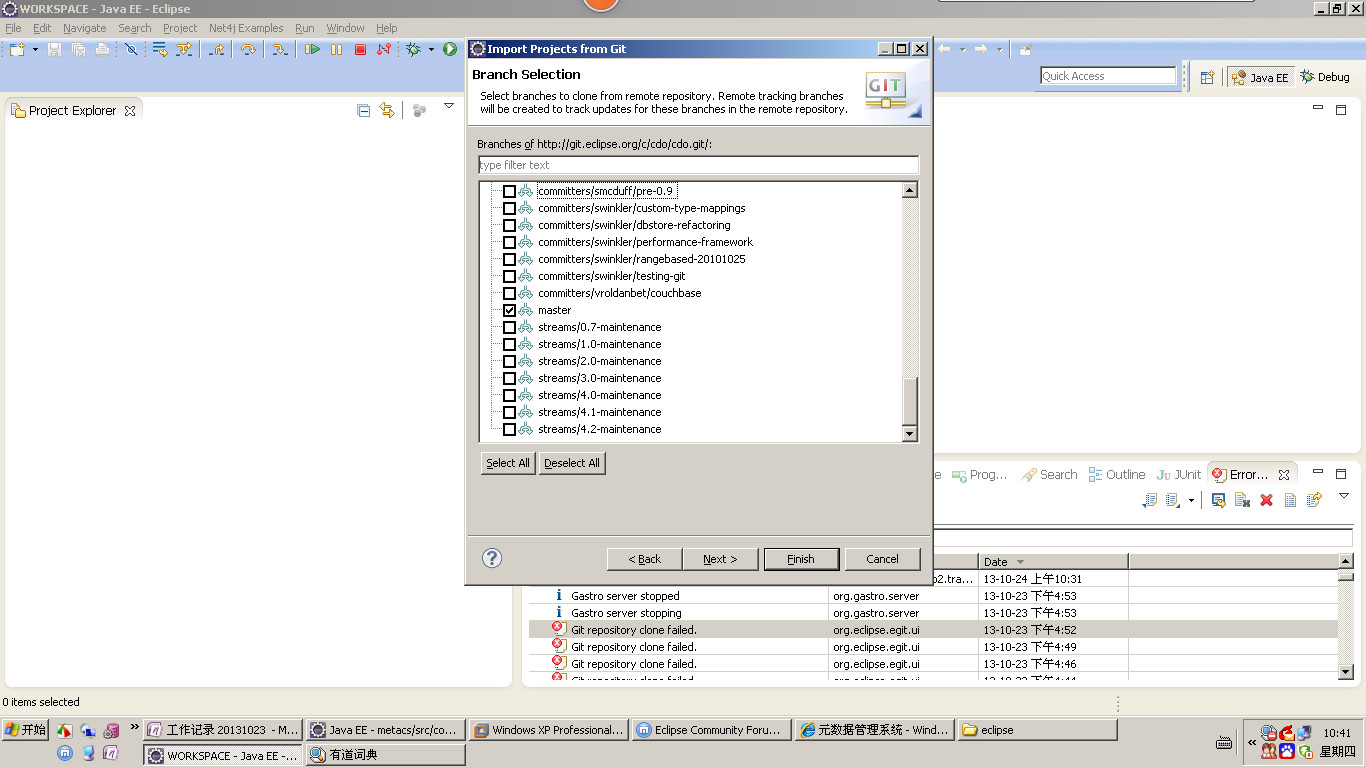

To clone the cdo repository: git clone http://git.eclipse.org/c/cdo/cdo.git/
index.php/fa/16537/0/
index.php/fa/16538/0/
index.php/fa/16539/0/
index.php/fa/16540/0/
Error message:
org.eclipse.jgit.api.errors.TransportException: Cannot download c65bb1c7430339c5042f1d46373571345f141db5
at org.eclipse.jgit.api.FetchCommand.call(FetchCommand.java:137)
at org.eclipse.jgit.api.CloneCommand.fetch(CloneCommand.java:178)
at org.eclipse.jgit.api.CloneCommand.call(CloneCommand.java:125)
at org.eclipse.egit.core.op.CloneOperation.run(CloneOperation.java:155)
at org.eclipse.egit.ui.internal.clone.AbstractGitCloneWizard.executeCloneOperation(AbstractGitCloneWizard.java:431)
at org.eclipse.egit.ui.internal.clone.AbstractGitCloneWizard.access$2(AbstractGitCloneWizard.java:424)
at org.eclipse.egit.ui.internal.clone.AbstractGitCloneWizard$5.run(AbstractGitCloneWizard.java:385)
at org.eclipse.jface.operation.ModalContext$ModalContextThread.run(ModalContext.java:121)
Caused by: org.eclipse.jgit.errors.TransportException: Cannot download c65bb1c7430339c5042f1d46373571345f141db5
at org.eclipse.jgit.transport.WalkFetchConnection.downloadLooseObject(WalkFetchConnection.java:601)
at org.eclipse.jgit.transport.WalkFetchConnection.downloadObject(WalkFetchConnection.java:412)
at org.eclipse.jgit.transport.WalkFetchConnection.doFetch(WalkFetchConnection.java:237)
at org.eclipse.jgit.transport.BaseFetchConnection.fetch(BaseFetchConnection.java:70)
at org.eclipse.jgit.transport.FetchProcess.fetchObjects(FetchProcess.java:247)
at org.eclipse.jgit.transport.FetchProcess.executeImp(FetchProcess.java:160)
at org.eclipse.jgit.transport.FetchProcess.execute(FetchProcess.java:122)
at org.eclipse.jgit.transport.Transport.fetch(Transport.java:1104)
at org.eclipse.jgit.api.FetchCommand.call(FetchCommand.java:128)
... 7 more
Caused by: java.io.IOException: http://git.eclipse.org/c/cdo/cdo.git/objects/c6/5bb1c7430339c5042f1d46373571345f141db5: 403 Forbidden
at org.eclipse.jgit.transport.TransportHttp$HttpObjectDB.open(TransportHttp.java:660)
at org.eclipse.jgit.transport.WalkFetchConnection.downloadLooseObject(WalkFetchConnection.java:591)
... 15 more

Re: [CDO]To clone the cdo repository: git clone http://git.eclipse.org/c/cdo/cdo.git/ Exception! [message #1152768 is a reply to message #1152495] Thu, 24 October 2013 02:50 Go to previous messageGo to next message
Try http://git.eclipse.org/gitroot/cdo/cdo.git ?
Re: [CDO]To clone the cdo repository: git clone http://git.eclipse.org/c/cdo/cdo.git/ Exception! [message #1152853 is a reply to message #1152768] Thu, 24 October 2013 04:04 Go to previous messageGo to next message
Am 24.10.2013 08:50, schrieb Felix Dorner:
No, that's the web viewer URL.
The git URL is git://git.eclipse.org/gitroot/cdo/cdo.git
Cheers
/Eike
http://www.esc-net.de
Re: [CDO]To clone the cdo repository: git clone http://git.eclipse.org/c/cdo/cdo.git/ Exception! [message #1154026 is a reply to message #1152853] Thu, 24 October 2013 21:15 Go to previous message
thank you ,Able to work properly!!!
