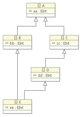

I reproduced a simple example to show you the issue (https://www.dropbox.com/s/1kjh7jkc4t8wq5o/fr.test.simple.zip).
This metamodel is composed of 5 eClasses (A..E), each has one eAttribute (aa..ee).
The Structure of the metamodel (inheritance and IDs in the real order) is as follow :
B->A (aa=0, bb=1)
C->A (aa=0, cc=1)
D->C (aa=0, cc=1, dd=2)
E->D,B (aa=0, cc=1, dd=2, bb=1, ee=4).
The issue I am pointing here is the same id value for (cc and bb).
Best regards

Hi Amine,
let me just to clarify how feature IDs work in the example you provide.
First, let's suppose that we have a model as the one you showed:
index.php/fa/17837/0/
And second, lets suppose we have the following code:

In this case, the output of the execution of this code is:
aa: 0:0
cc: 1:1
dd: 2:2
bb: 1:3
ee: 4:4
As you can see, there's a difference between feat.getFeatureID() and e.getFeatureID(feat). That's because the method org.eclipse.emf.ecore.EStructuralFeature.getFeatureID() returns the ID relative to the containing class. The ID for both cc and bb is 1 relative to their corresponding classes (C and B). It makes sense, since B.bb and C.cc, as isolated elements, do not know that are also included in a subclass E.
In this case, to get the right numeric ID for a feature in a specific EClass, you have to ask that same EClass for the ID using the method org.eclipse.emf.ecore.EClass.getFeatureID(EStructuralFeature feature).
Abel
