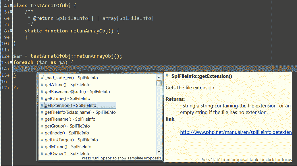

icon6.gif  Re: How to format @return javadoc comments for multitype [message #1146897 is a reply to message #1146886] Sun, 20 October 2013 09:41 Go to previous message
In my daily practic i use this:
@return SplFileInfo[] | array[SplFileInfo]
see attach.
