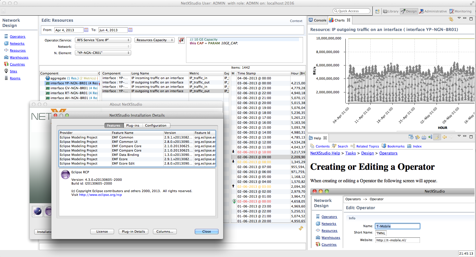

I finally started upgrading my RCP application to the latest Eclipse version which is Kepler (4.3.1).
Getting the application to compile and run was not very hard, see (1).
However I hit many smaller compatibility issues see (2). Most of them can be worked around. But one of which is a showstopping issue for us which I don't know how to fix so I will use 3.x for the time being. People who don't use any "dirty tricks" can probably safely migrate to 4.x.

(1)
I am using a custom target platform as advised. Besides the org.eclipse.rcp feature I had to manually add the following features from update site http://download.eclipse.org/releases/kepler/:
EMF - Eclipse Modeling Framework Core Runtime
EMF common
Eclipse Kepler comes with: 2.9.1.v20130827-0309 so used this version.
Had to add required plugins to launcher, and manually add these plugins for the console to work:
org.apache.felix.gogo.command , org.apache.felix.gogo.runtime , org.apache.felix.gogo.shell
My product is based on a feature, so had to recreate the feature given this launch configuration.
