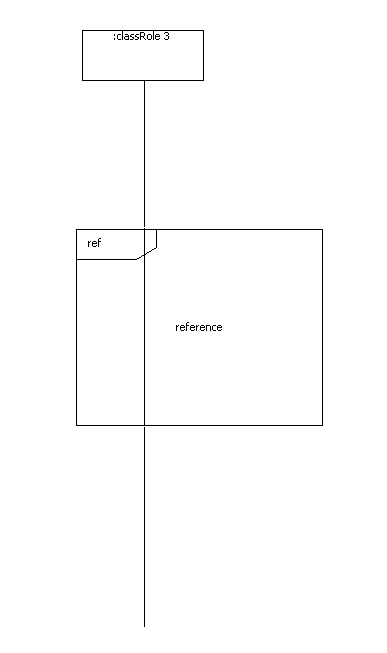

Hi all,
I have a problem. I have set the figure as Opaque. But still when I drag a
figure over another figure, I can view the figure in the background. All my
figures are drawn using the paintFigure() method. Can someone please tell
me, what could be the possible problem here?
Binti.

Re: Figures not being Opaque [message #176316 is a reply to message #176283] Fri, 08 April 2005 20:12 Go to previous messageGo to next message
Originally posted by: binti.ksu.edu
Hi Pratik,
Here is a screen shot. Both these figures are opaque.
Binti.

Re: Figures not being Opaque [message #176361 is a reply to message #176316] Sat, 09 April 2005 12:32 Go to previous messageGo to next message
Binti,
Are you talking about the connections? Connections are always above the
other figures because the connection layer is above the layer on which the
figures are drawn.
Also, you cannot drag a figure "over" another figure. The order in which the
figures are drawn (which affects how figures overlap each other) depends on
their index in the list of their siblings.
Search for "z order" in this newsgroup - that thread should give you some
pointers.
Hope this helps,
Brian.

Re: Figures not being Opaque [message #176444 is a reply to message #176361] Sun, 10 April 2005 20:14 Go to previous messageGo to next message
I am not talking about connections. The screenshot I sent had no
connections. I willl try to look into 'z order'. Thanks.

Re: Figures not being Opaque [message #176579 is a reply to message #176444] Sun, 10 April 2005 20:35 Go to previous messageGo to next message
Are you invoking super.paintFigure() from your paintFigure() method?

Re: Figures not being Opaque [message #176587 is a reply to message #176579] Sun, 10 April 2005 22:20 Go to previous messageGo to next message
Thanks Pratik,
That helps. But the z-order is another problem. I did not find much thread
on it. Could you explain how and where it is set. And how to change it?
Also, now the connections still show and as Brian explained, they will
always shpw as the connection layer is on the top of other layers...is there
a solution to it?
Binti.

Re: Figures not being Opaque [message #176603 is a reply to message #176587] Mon, 11 April 2005 01:32 Go to previous messageGo to next message
"Binti Sepaha" <binti@ksu.edu> wrote in message
news:d3cn7i$6tj$1@news.eclipse.org...
> Thanks Pratik,
The z-order is simply the order in which the figures are listed in the
parent (which is usually the order in which they were added). A figure will
paint over any of its preceding siblings. That is to say, with two
overlapping figures, the one that was added last will be on top. To change
this order, simply change their order in the parent figure's list.
there
> a solution to it?
Solution to what? Connections appearing over figures? So, you want your
connections to go under the figures? Switch the order in which the
connection layer and the primary layer added to the layered pane in the root
editpart. Same concept that I explained above.

Re: Figures not being Opaque [message #176638 is a reply to message #176316] Mon, 11 April 2005 11:13 Go to previous messageGo to next message
Originally posted by: none.us.ibm.com
setting opaque is not magic, it's just a boolean. You still need to call
super.paint(), or your bounds will not be filled in with the background
color.
Re: Figures not being Opaque [message #176938 is a reply to message #176603] Tue, 12 April 2005 11:52 Go to previous messageGo to next message

"Pratik Shah" <ppshah@us.ibm.com> wrote in message
news:d3d2fv$im7$1@news.eclipse.org...
>> Thanks Pratik,
>> thread
> will
> change
> there
>> a solution to it?
> root

Re: Figures not being Opaque [message #176946 is a reply to message #176938] Tue, 12 April 2005 13:00 Go to previous messageGo to next message
It's in your root editpart. In your editor's configureGraphicalViewer()
method, you must be specifying a root editpart. Subclass that root
editpart's createPrimaryLayers() method or something like that.

Re: Figures not being Opaque [message #177003 is a reply to message #176638] Tue, 12 April 2005 14:05 Go to previous message
I did what Pratik suggested and now things look good, but the only problem
is my connections are no longer selectable. How do I change this? Also, my
connections have labels attahced to them which do not show initially, but
once i close and reopen the diagram, they appear.
Please guide me though this too :)
