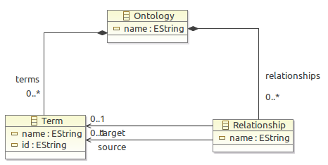

In order to better understand the problem and the grammar language I created a small toy example with a toy domain metamodel that represents the main issue I want to address. You can see this metamodel in the next figure.
index.php/fa/16446/0/
The approach is quite simple (and I think you are familiar to the main idea): An ontology has terms and relationships. Terms represent entities of a domain and can be seen as nodes of a graph. Relationships represents directed relations that hold between two terms and can be seen as arcs between two nodes of a graph, linking one term (source) to another (target). Terms and Relationships has an reference called 'ontology' that points to the ontology that are their container. I have some constraints and derivations written (and working) using OCL, but I think structural features are more important in the example.
