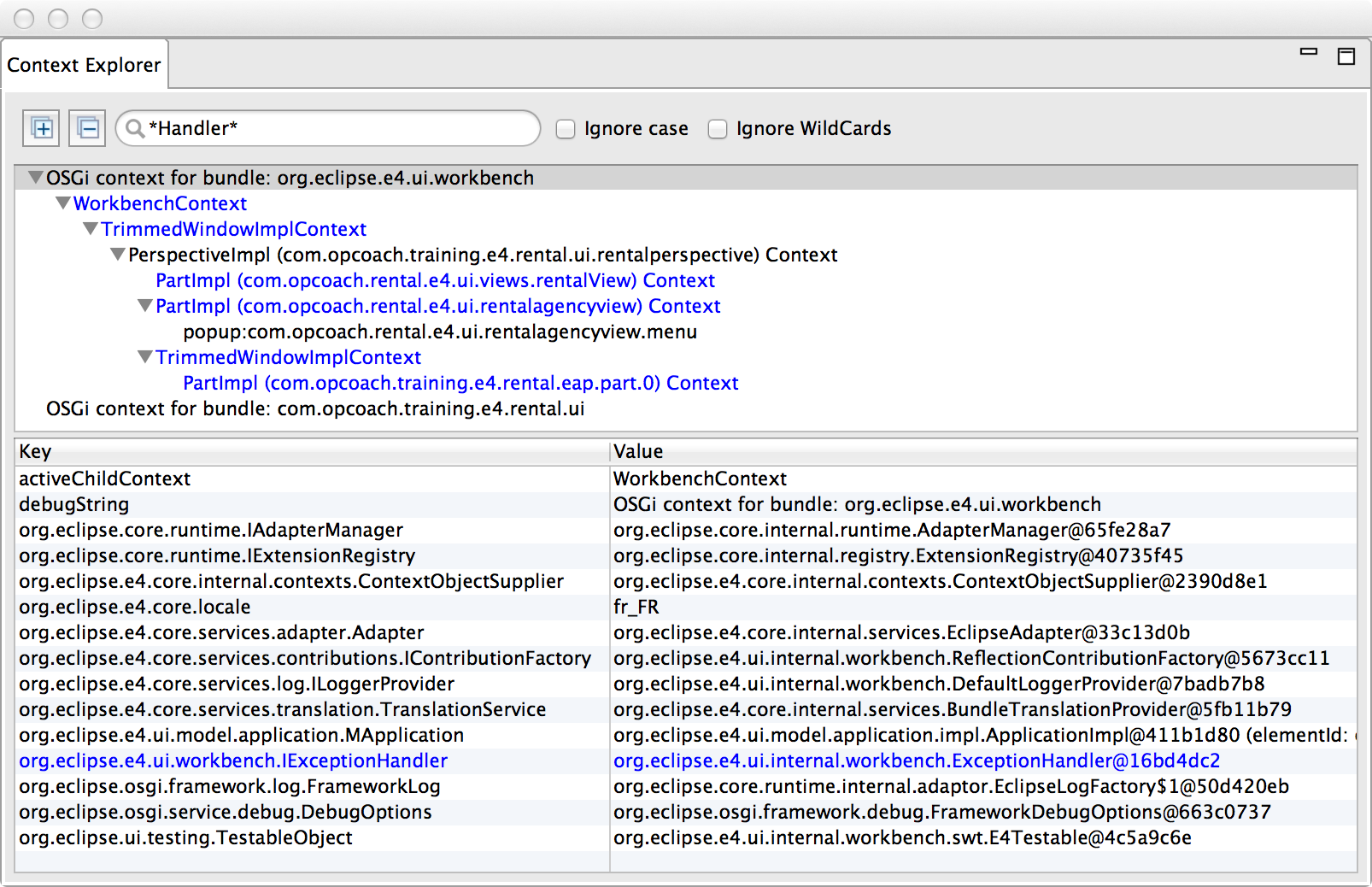

This post is not a question. It is just a reminder to give you information about the context Explorer. This tool is free, developed under EPL license, and can help you to see what is available in your E4 contexts.
Feel free to download the project from github (github.com/opcoach/contextExplorer) and then get the contextExplorerPart in your application with this URI :
bundleclass://com.opcoach.e4.contextExplorer/com.opcoach.e4.contextExplorer.parts.ContextExplorerPart
You can get more information using the 2 links (french and english) on the main github page of the context explorer.
