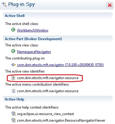

> Hi All,
> I am a beginner to eclipse plugin development.
> I am trying add an item to context menu when doing a right click on project. I am able to do it in Project explorer view with the locationURI in menucontribution. Snippet as below:
> <extension point="org.eclipse.ui.menus">
> <menuContribution locationURI="popup:org.eclipse.ui.navigator.ProjectExplorer#PopupMenu?after=additions">
Yes, the project explorer is designed to be extensible...
> I tried to get the identifier for Broker Application Development Navigator with Alt+Shift+F1 which gives me com.ibm.etools.mft.navigator.resource (screenshot attached), but this does not get me the control over the menu to add the menu item.
It's possible that this implementation class doesn't use the extension
registry to help populate the menu or doesn't include and "additions"
separator which might cause problems too. It's hard to say because
that's clearly some IBM code and likely can't see that source...
Perhaps better to ask on a forum specific to that tool...
> <menuContribution locationURI="popup:com.ibm.etools.mft.navigator.resource#PopupMenu?after=additions">
> Please help. Thanks a lot in advance.
