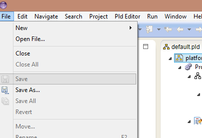

for some reasons it seem that the save button in my EMF editor is disabled:
index.php/fa/16330/0/
Which method responsible for determing if a save is needed? IsDirty in my xxxEditor?:
public boolean isDirty() {
   return ((BasicCommandStack)editingDomain.getCommandStack()).isSaveNeeded();
Cheers,
Phil

I had a closer look at the isDirty method and it turned out that every time I add something to the model it returns true and if I undo this it returns false. So it seems to work as expected, but save is still disabled. What can be another reaon for this?

Re: Save disabled [message #1127512 is a reply to message #1123394] Sun, 06 October 2013 15:29 Go to previous messageGo to next message
Hi Ed,
thx for your patience with me. I had a look at the code you mentioned and it turned out that it's called every time I change something in the model. So this mans the editor checks the dirt state (which is true) then and should enable saving?
What I also observed:
- "Save all" works as I expected - every time the model change, "Save all" is enabled and I can save my model.
- when I close the file, the question "..has been modified. Save changes?" occurs and I'm able to save my model.
