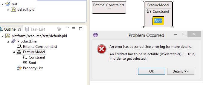

I've got a problem with my GMF editor. When I create a new diagram and click on an item inside the outline, everything thing works as expected. But when I first click inside the diagram and then choose an item from the outine view, I get the following error:
index.php/fa/16327/0/
Any ideas about this? AbstractGraphicalEditPart implements isSelectable(), but I'm not really sure wether this is causing the problems.

what is shown if you click on details in this dialog? Do you get an exception?
Ralph
Re: Error: EditPart has to be selectable [message #1123335 is a reply to message #1122086] Wed, 02 October 2013 09:06 Go to previous messageGo to next message
"An error has occurred. See error log for more details. An EditPart has to be selectable (isSelectable() == true) in order to get selected."
So, not much informations..The console gave me the following output:

Re: Error: EditPart has to be selectable [message #1127513 is a reply to message #1123335] Sun, 06 October 2013 15:30 Go to previous message
any further suggestions? I tried to implement isSelectable without any success:
public boolean isSelectable() {
	return true;
I found this bug (https://bugs.eclipse.org/bugs/show_bug.cgi?id=351433) which seems to be similiar?
