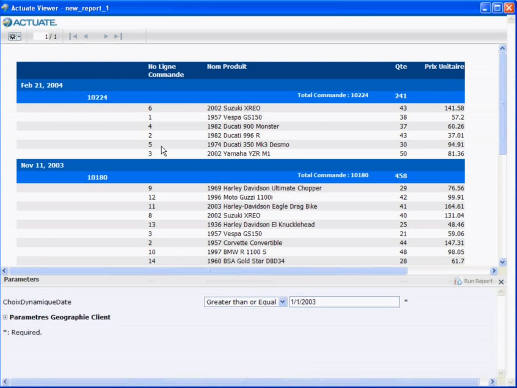

I was watching this youtube video on Cascaded Parameters: http://www.youtube.com/watch?v=mhFFwRwx11Q
At 3' 35" (see attachment), it shows the custom parameter page as part of the report view. I have googled until my fingers bled but I cannot find how to do this in BIRT. Is this an Actuate Viewer feature only?
Kind Regards,
Erwin
Re: Custom Parameter Page in Report View - How? [message #1138443 is a reply to message #1118662] Tue, 15 October 2013 01:11 Go to previous message
This is just the way the Actuate viewer is set up. To do this with open-source BIRT, you'd need to modify the viewer or you could use the tag library and create a JSP with a custom parameter page and embedded viewer.
