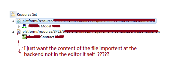

ok I just added this code to my editor :
editingDomain.getResourceSet().getResource(URI.createURI("other model directory "), true);
However, is there is a way to load it without showing it in the editor .
please check attachment
salwa
Re: models referencing across editors [message #1222157 is a reply to message #1221345] Thu, 19 December 2013 14:48 Go to previous messageGo to next message
Salwa,
What shows in the editor depends on the setInput for the view. If you
set the resource set as the input (what the generated edtitor does by
default), ResourceSetItemProvider will show all resources. Do you just
want to show one resource? Perhaps set the resource set's first
resource as the viewer's input.
> salwa
Re: models referencing across editors [message #1222328 is a reply to message #1222157] Fri, 20 December 2013 01:58 Go to previous message
Thankx Ed for the reply ,
WEll, I tried this at the beginning , but it seems the property views always read from the viewer input , so only the elements from the resources set that I picked will be shown and it is not what I want ..
SO what I did , I set the input to the viewer to the whole resource set (my three model) , and then I setup a viewer filter to show only the resource set that I am interest in... the property view at the same time will keep showing the elements from the three models.
The only problem I have now , is when ever I update one model "add new elements" in its own editor , the other models can't see the new changes
any suggestion !!??
