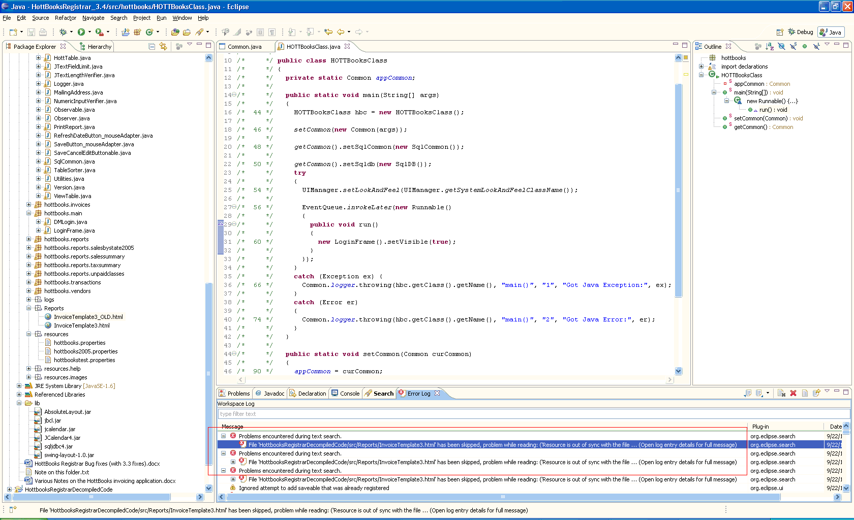

I've been using text search functionality built-in to Eclipse, but certain files in my project are no longer being searched. I get an error saying:
Resource is out of sync with the file system: '/HottbooksRegistrarDecompiledCode/src/Reports/InvoiceTemplate3.html'. The error is towards the bottom-right of my screenshot, which I have attached to this post.
Now, you can see that the InvoiceTemplate3.html is part of my workspace on the left of my screenshot. How do I "resync" that file, so that I can search it with Eclipse's text search functionality?
Re: Text Search function failing b/c "Resource out of sync with the file system" [message #1115102 is a reply to message #1114478] Mon, 23 September 2013 13:05 Go to previous message
Perform a refresh on the project to resync the files.
