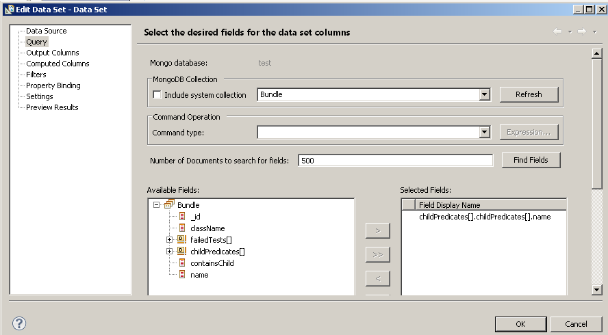

Re: mongodb-oda-birt-plugin - JSONPath [message #1117184 is a reply to message #1116768] Thu, 26 September 2013 03:13 Go to previous message
Hi, thanks for response.
I just tried BIRT 4.3 with such query - see picture: index.php/fa/16297/0/

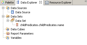

In BIRT Data Explorer one cane see it - see picture: index.php/fa/16298/0/

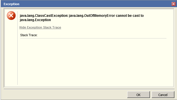

When I place the field on report and switch to preview pane got an exception: index.php/fa/16299/0/
