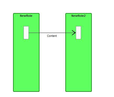

Hi all. I'm developing an UML sequence diagram editor with Graphiti and I'm facing some problems in accessing the underlying business objects in a correct way.
First, I show you my prototype.
index.php/fa/16223/0/
Green rectangles are roles. They're linked to a Role business object.
White rectangles are so-called activation rectangles. They describe the activity of a role during its lifetime.
Arrows are messages. Messages can be drawn between two activation rectangles, they're linked to Message business objects AND they need to refer to the originating roles.

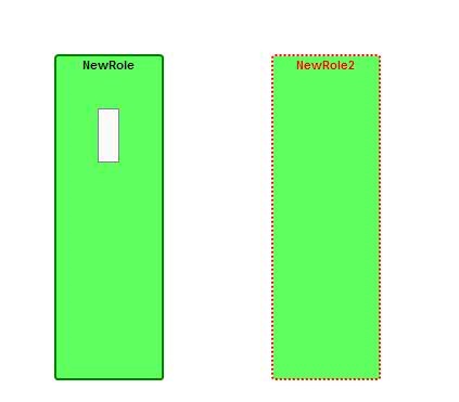

This solution seemed to work well, but there's a problem related to it.
When I delete an activation rectangle Graphiti destroys the linked business object (despite other pictograms are still linked to it)... and the role is gone!
index.php/fa/16224/0/
This is definitively not good (even if there's an easy fix: when deleting an activation rectangle mind to use only the remove button).
