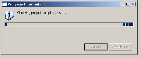

I have few hundred testcases in my test suite(s)
From last couple of days the Jubula takes quite longer (on an aerage 2mints) to save the changes made at suite/testcase level and every time it displays a progress bar "Checking for project completeness ..."
I have verified with the database admin that there is no issue with the database, which must be causing the delay
I have also tried to,
- Delete the workspace and start a fresh
- Increase memory in jubula.ini
- Delete the older test results
Is there any other way to figure out the root cause ?
Any help/suggestion is much appreciated.

Re: Jubula takes longer to save the changes [message #1107211 is a reply to message #1105807] Thu, 12 September 2013 01:06 Go to previous messageGo to next message
Can anyone please comment why every time jubula checks for project completeness ?
Are there any settings to turn it off ?

Re: Jubula takes longer to save the changes [message #1107300 is a reply to message #1105807] Thu, 12 September 2013 04:06 Go to previous messageGo to next message
This has been resolved now.
The issue was due to event handler configurations, where one event handler 1 was calling 2 and 2 was calling 3 ... the depth was till 5
Removing them, helped jubula to restore workable env.
Bhupendra
