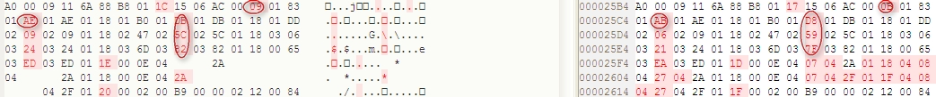

I used the different version of eclipse to compile the same java file, the name of java file is "CRSApp.java".but the class file of the jave file is much different. the vesion 3.1.1 and vesion 3.7.2 of eclipse. the function of "getStatusProcessScan" in "CRSApp.java" may have 9 exception table,but the version 3.7.2 have 11 exception table.
the attach . an adequate account is attachments of "different jpg", would you please give me some help ?

That likely depends on your Java compiler options for things like the
language compliance level. I.e., whether you're generating code for
Java 1.4, 1.5., 1.6 or 1.7.
