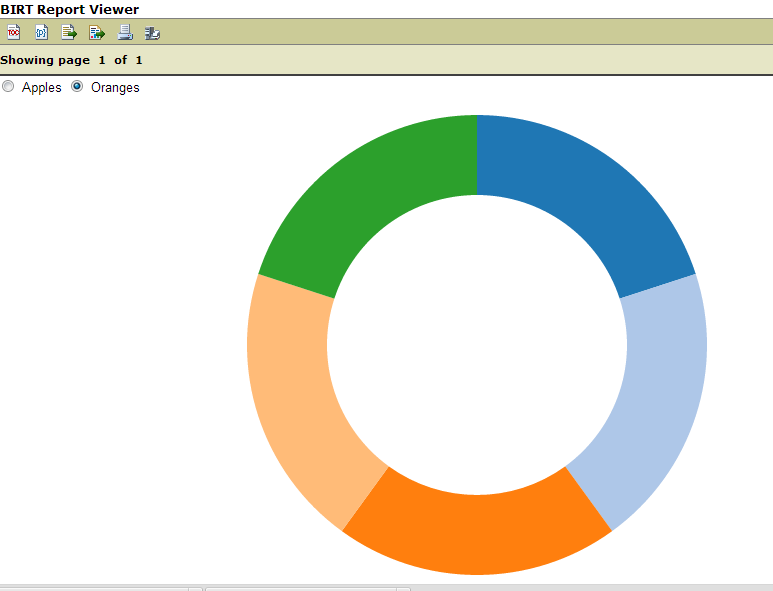

Your example works as it is, see image attached.
index.php/fa/16183/0/
Preview it in an external browser such Chrome rather "preview" Eclipse feature. However a bad news is, it won't work with Internet Explorer: sadly the birt viewer starts IE in a old compatibility mode (IE7). This prevents any HTML5 feature such D3 to run.
Note this is a bug of the viewer, not the report engine: if you run the report with your own servlet or another viewer it will work in IE too
