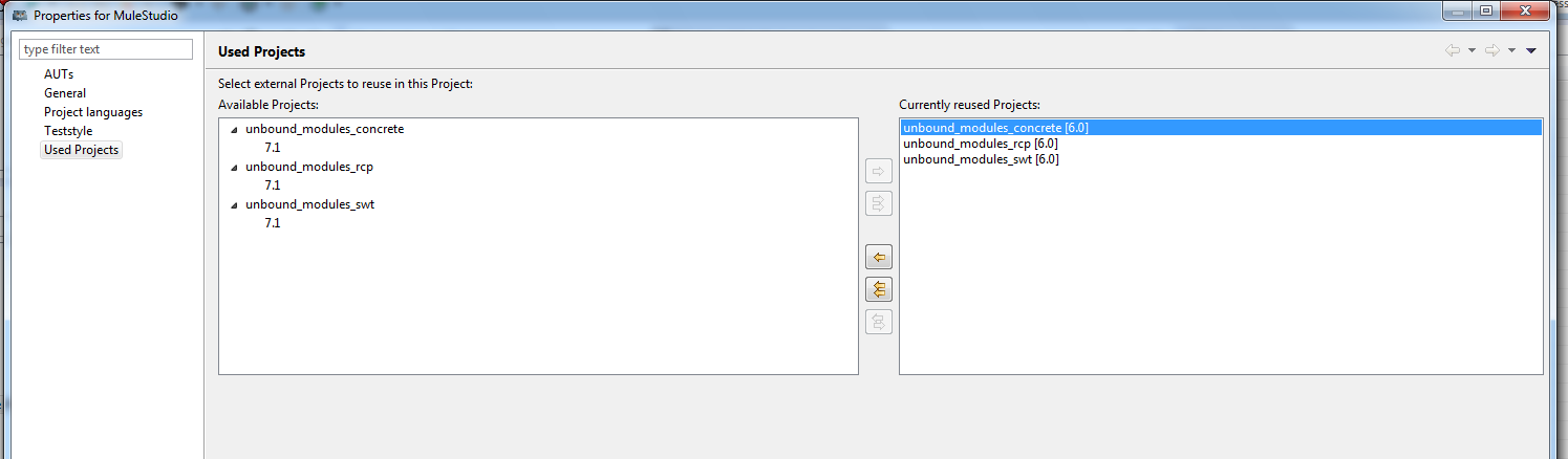

Hi, I'm trying to upgrade the Jubula version from 1.3.0 to 2.1.0
Till now I have created a new database and imported all my test cases from my previous database, but the problem I have is followed:
When I go to - Test menu > Properties, under used projects section, I have the previous version of the used projects (version 6.0) but I can not remove them because they are being used by all my test cases.
Also, all the test steps / cases do not exists in this version. So I have many errors with empty references.
And I'm not able to add the new version of the projects ( version 7.0 ).
Any ideas how to fix this?
Check attached screenshot.

It looks like the correct version is in the database from the screenshot. You have to select both the old and the new versions though, to perform the switch, as documented here
Hope that helps!
Alex
