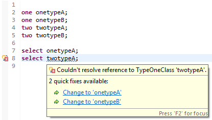

I think my problem is well-known, but I couldn't find out how to handle this situation: I've got two different rules which are equally valid for the parser. Xtext/Antlr cannot handle this situation alone, but I think it should be possible (even though not in an early stage of parsing, since additional information about referenced types is required). Let me give an example:

My first idea was to use a syntactic predicate to tell the parser that it should use TypeOne. I hoped that the parser would use rule TypeOne, but would fall-back to TypeTwo if the reference cannot be resolved.
AnyType returns Target:
    (=> TypeOne) | TypeTwo
Unfortunately this doesn't work; the screenshots show what's happening: scoping works fine (this is a little bit unexpected), but any reference to a TypeTwoClass cannot be resolved (because only TypeOneClasses are accepted - this again is as feared).
How can I solve this issue? I thought that I might have to enable backtracking, but woudn't like this... And I fear that this won't work anyway.

  • Attachment: scoping.png
    (Size: 7.25KB, Downloaded 147 times)
  • Attachment: resolving.png
    (Size: 11.87KB, Downloaded 143 times)
