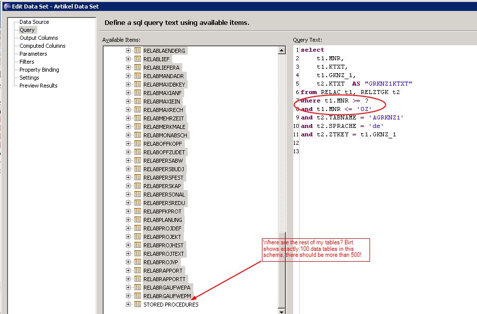

I am using an Oracle instant client 10.2 to access an Oracle 8i database.
My first problem is that the designer shows only 100 data tables in the schema that I specified. There should be more than 500 tables though. Is there a setting that limits the schema table count to 100?

Re: Oracle Data Source [message #1091916 is a reply to message #1090586] Thu, 22 August 2013 01:23 Go to previous messageGo to next message
The schemas/tables are limited in the preferences:
Window -> Preferences -> Report Design -> Data Set Editor -> JDBC Data Set
For the second issue, can you attach your design?
Re: Oracle Data Source [message #1091969 is a reply to message #1091916] Thu, 22 August 2013 02:55 Go to previous messageGo to next message
Thanks a lot! I suspected something like this, 100 was too straight to be accidental. Smile
