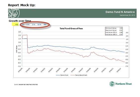

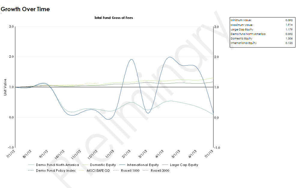

I have a challenging requirement where I have to show line chart for one timeperiod at once and if user selects other time period that is placed above the chart like shown in the screen shots below then he should be able to see the data for that chart only for that particular time period.
So, I have like 5 time periods that user can select in front end and when the report is generated by default the chart will show data for one time period at one time and when he clicks on next time period he should see similar chart with data related to that time period.
Can we accommodate this by using single line chart and that triggers when clicked on each different time period.
I have no idea on this type of things..can some one please help me out.
Please find the attached screen shots and report.
