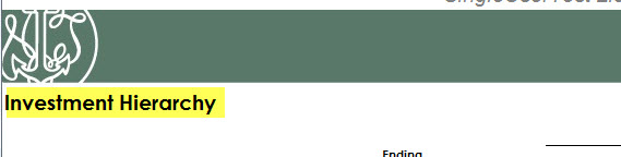

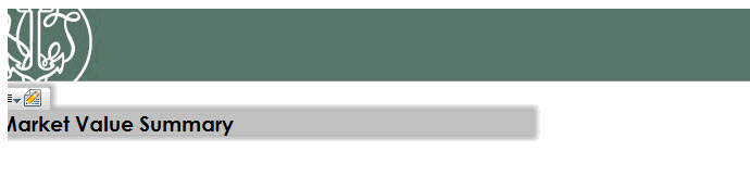

I have a report that has many templates in it, and when I use LABEL for template title I was able to edit the report title on IV at run time,
whereas in other case I have to use data element for my template title as the title is not constant at all times so I am using Java script expression in data element,
in this case when I run the report and on IV I can't edit the report title like I did when I use Label.
Is there a way I can do it by using data element or is it element limitation.
Please advise.
Please find the attached screenshots for reference.

Re: Edit Report Title on IV [message #1086762 is a reply to message #1085317] Wed, 14 August 2013 13:28 Go to previous message
Yeah. It appears it can only be a static label that can be changed. I tried changing the value in script, but it ended up not taking the change value even though it appeared it would.
