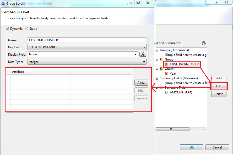

Re: Cross tab hyperlink parameters [message #1078977 is a reply to message #1078416] Sat, 03 August 2013 18:40 Go to previous messageGo to next message
Take a look at the attached image on how to add an attribute to a dimension field.

Re: Cross tab hyperlink parameters [message #1078988 is a reply to message #1078977] Sat, 03 August 2013 19:01 Go to previous messageGo to next message
Sorry, I forgot to respond about the linked groups. A way that can be used would be, say you have a dataSet used for the dataCube with the payments table from the classic models db. You want to use the customername that you have in another dataSet where you bring in the customernumber and the customername. Rather than joining the dataSets, you could drag the customername from the second dataSet to be used as a dimension in your cube. Then in the link groups area, you'd like the two customernumber fields so BIRT can map the correct value.
