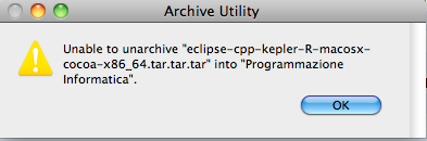

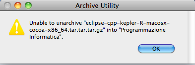

I am a new user and new to the world of programming too. I have downloaded and installed without problem Eclipse IDE for Java Developers. Now I cannot install Eclipse IDE for C/C++ Developers. I was following the same steps I did for the previous one, but I get this error message from the application which is trying to unzip the file I downloaded from Eclipse website: "unable to unarchive".

- I tried to unarchive the downloaded file for C++ with both extensions (as you may see on the pictures encl.) .tar and .tar.gz but without success.

I don't know why it's called .tar.tar.tar but that may have something to do with it. Try downloading it without changing the name.

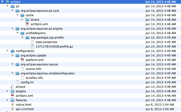

- I finally was able to unarchive it with Stuffit Expander but the content seems missing something (where is the file to click to launch the program for example?). I attach a screenshot of the unzipped content of it.

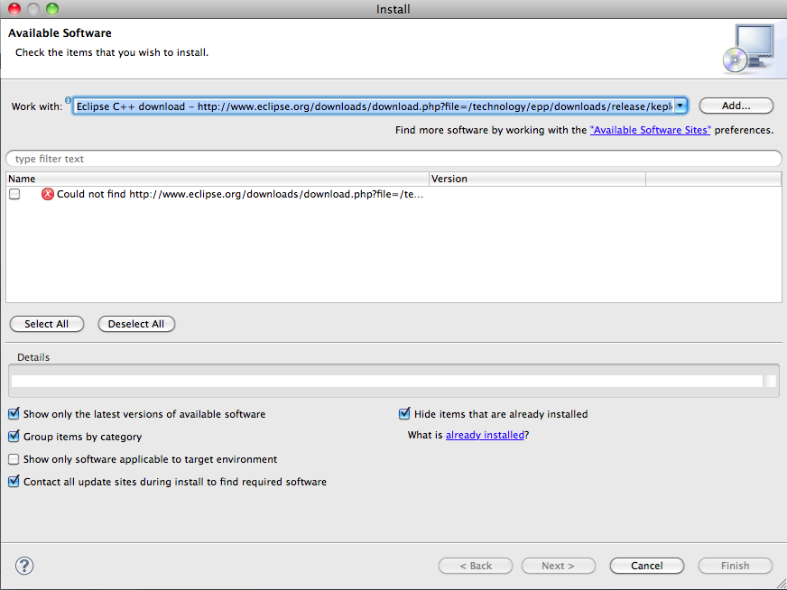

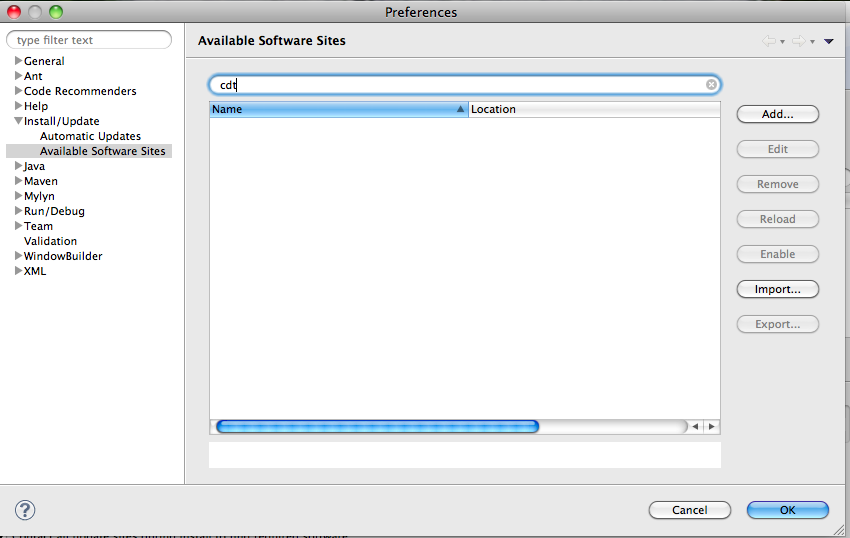

- I tried to install new software on my working version of Eclipse IDE for Java developers but after clicking Available Software Sites, then type cdt in place of "type filter text" I get no proposals for a download (see pictures) I tried also to manually insert paths like http://www.eclipse.org/downloads/download.php?file=/technology/epp/downloads/release/kepler/R/eclipse-cpp-kepler-R-macosx-cocoa-x86_64.tar.gz but no success either.
