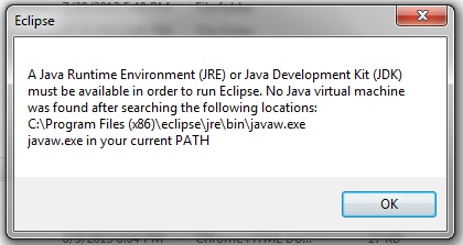

Running Eclipse resulted every time in this error:
index.php/fa/15755/0/
I finally found the instructions about editing the eclipse.ini file to point at a particular JDK (Yes, I have downloaded and installed the JDK with netbeans, netbeans by the way works great right out of the box).

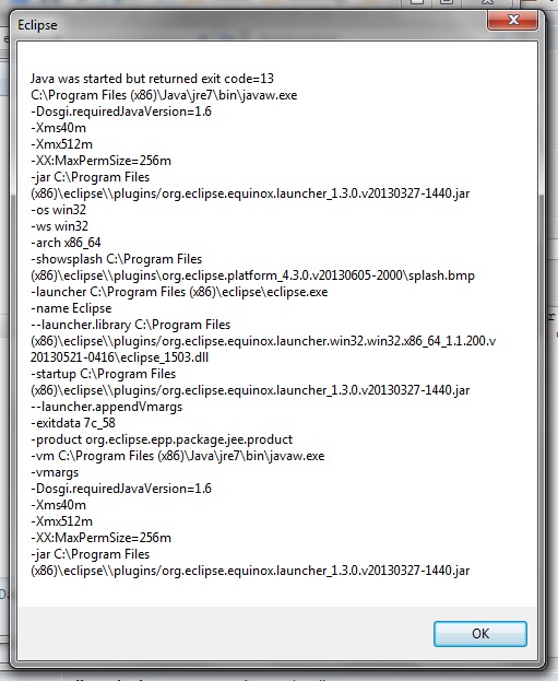

the first one gave me the same error as above with this new path. The second and third both look like they are going to work and then produce this exit code 13 error
index.php/fa/15756/0/
So, I'm at a complete loss. How do I point eclipse at an appropriate JDK so that it will run?

Error 13 usually means a 32/64-bit mismatch; in your case, a 64-bit Eclipse JavaEE package download that can not use the 32-bit Java installations. Try the 32-bit download instead.
Also, don't tell Eclipse to use the executables under the jre subdirectory of a JDK install, use the ones in the main bin directory--like "C:\Program Files (x86)\Java\jdk1.7.0_07\bin\javaw.exe".
Re: Can't get eclipse to run [message #1076241 is a reply to message #1075808] Tue, 30 July 2013 22:25 Go to previous message
Thanks for your help. I downloaded a 64 bit JDK, pointed eclipse at it and it ran. Problem solved
