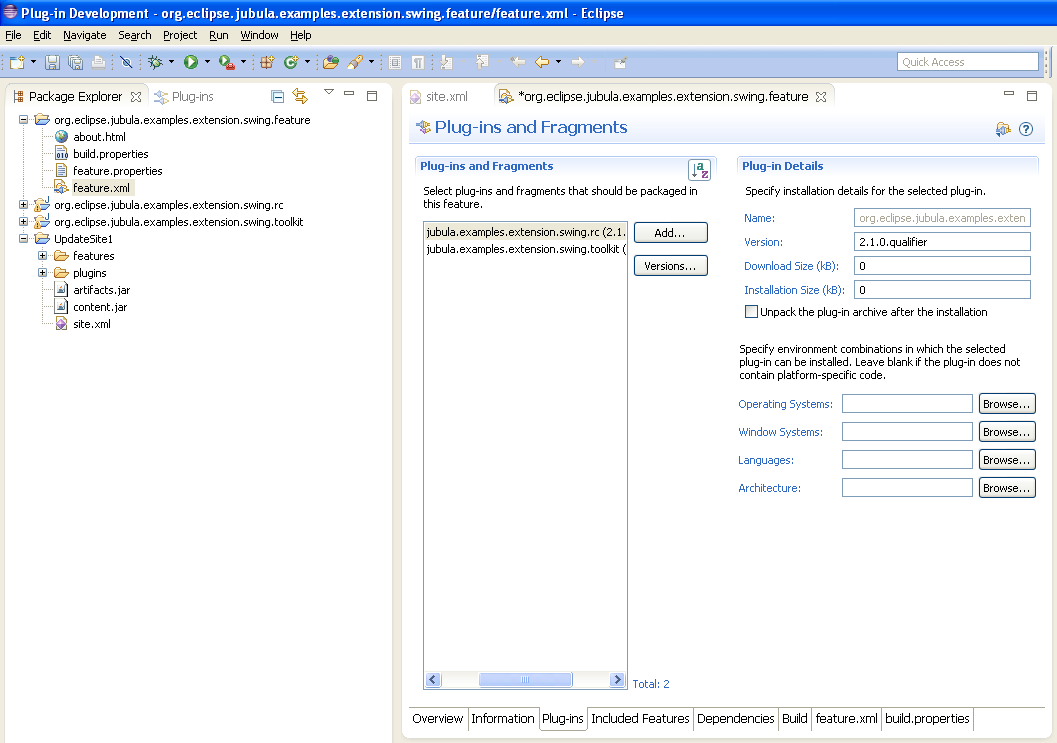

I've also created an Update Site project referencing my feature project. The rc fragment project is already referenced in the feature project in the plug-in tab (see the first attached image).

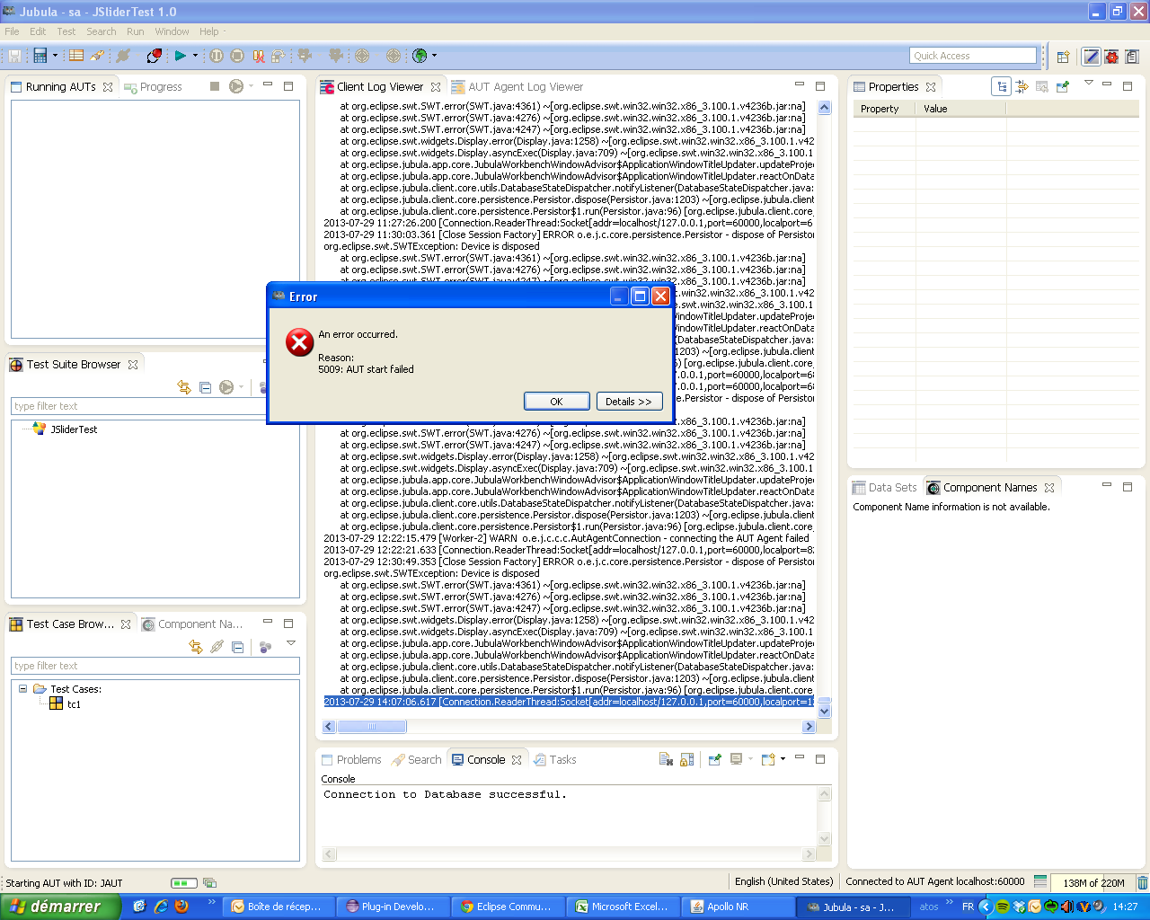

I can install my feature from the ITE, I even see the Swing JSlider actions, but I can't run the AUT as it fails on error 5009 (see the second attached image).

The logs from the ITE don't really help. Here's the client log:
2013-07-29 14:07:06.617 [Connection.ReaderThread:Socket[addr=localhost/127.0.0.1,port=60000,localport=12258]] ERROR o.e.j.c.c.c.StartAUTServerStateCommand - AUTServer could not start: Error while starting AUT!
and the AUT Agent log:
