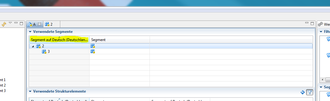

I want to check if my tree table has a specific column (I can add and remove columns in the application).
I haven't found a direct solution for this and so I try to select the header with ub_trt_selectEntryByIndexpath_specifyColumn and then check with ub_trt_checkSelectionByValue(s)_specifyColumn if the selected header has the right text (and as a result, is the column I need).

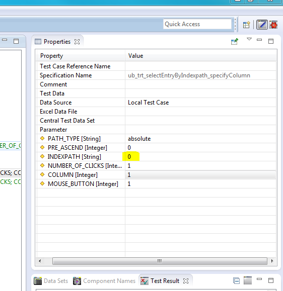

According to the Jubula manual, Chapter 5.7.3, the table header can be selected by selecting the index 0. Unfortunatelly this doesn't work (see screenshot of my parameters below) because the Tree Node can't be found (Error Description Tree Node not found).
If I set the index to 1, Jubula selects the first node below the table header.
index.php/fa/15696/0/
My tree table
index.php/fa/15694/0/
My settings for ub_trt_selectEntryByIndexpath_specifyColumn
