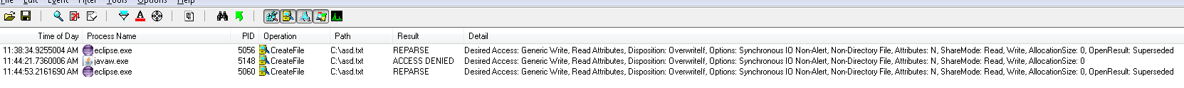

Looking around with process monitor, I'm seeing actual differences between running from eclipse and from an exported application:
index.php/fa/15687/0/
The standalone application (eclipse.exe) returns with REPARSE, while running from eclipse (javaw.exe) returns with ACCESS DENIED.
