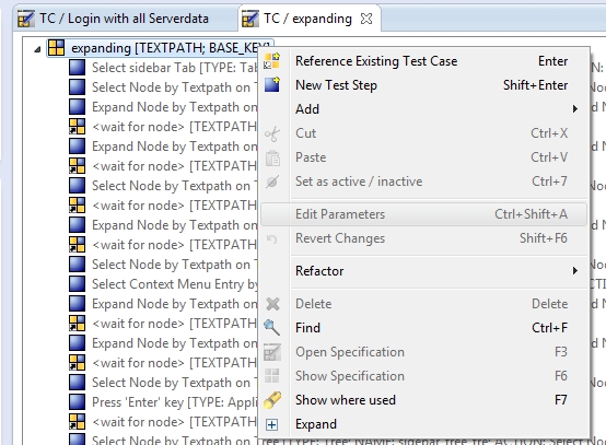

I made a mistake and added a parameter to my test case by typing "=BASEKEY" in one of my key combination sequenzes as a value. Now I want to remove it because I decided to use a fixed value ('ENTER').
I read the section in the manual and found this thread. But as you can see on the screenshot below, I can't select "Edit Parameters" from the context menu. Am I doing it wrong?

Per this forum post, your project may be set to "protected", which would be disabling Edit Parameters.
Try this: with your project open, open Test-->Properties and select the "General" option. There should be an "Is Protected" checkbox there.
Re: Can't remove parameters from test case [message #1073254 is a reply to message #1073061] Wed, 24 July 2013 08:02 Go to previous message
Thank you, you solved my problem. Smile
