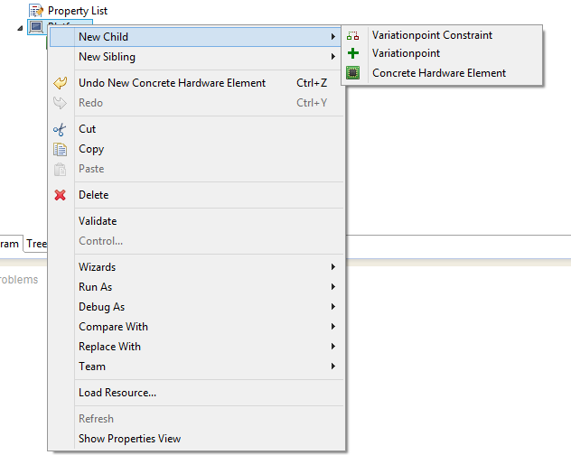

I'm not sure if it's called context menu, but I mean the menu which opens by right clicking elements in the EMF editor (see image).
index.php/fa/15643/0/
1. Is it possible to remove/add new context menu entries? If yes, which class is responsible for this?
2. I would like to modify the "new child" menu items in order to add new menu items which create then the accordingly objects. Will it be effort to realize this?
Hope you understand what I'm meaning. Otherwise I'll try to explain more detailed.
Cheers,
Phil

Phil,
Comments below.
On 19/07/2013 12:44 PM, Phil H wrote:
> Hi,
Yes, that's right.
Of course. You can look in your generated XyzActionBarContributor to
see how it populates these menus.
Probably you should do this by specializing the protected void
collectNewChildDescriptors(Collection<Object> newChildDescriptors,
Object object) methods and let the existing infrastructure populate the
menu from that information.
> Cheers,
> Phil

On 19-07-13 12:51, Ed Merks wrote:
> Phil,
> Comments below.
>> Hi,
> Yes, that's right.
Something I use is the IChildCreationExtender interface.
You can define a concrete implementation in a plugin.xml
<extension
point="org.eclipse.emf.edit.childCreationExtenders">
<extender
class="MyCoolChildCreationExtender"
uri="http://package uri for your package holding the objects">
</extender>
The extender is consulted when selecting an object in your view,
so instead of having static definitions in your
collecNewChildDescriptors you can make it dynamic by considering your
model status or UI options. I prefer this way, as the ItemProviders are
difficult IMHO to be fed with the model or UI stuff.
>> more detailed.
>> Cheers,
>> Phil

Ed Merks wrote on Fri, 19 July 2013 12:51
Phil,
Comments below.
Thx Ed,
I had a look inside this class, but could only see how the Child and Sibling menus are realized. I'm wondering how I could remove the Wizard, Run as or Debug as entries?
Christophe Bouhier wrote on Fri, 19 July 2013 14:17
<extension
<extender
</extender>
Thx Christophe,
are there any examples or tutorials how to use this interface. Or maybe any running example so that I can see how these interfaces looks like?
Cheers,
Phil
Re: Customizing conext menu [message #1075867 is a reply to message #1075643] Tue, 30 July 2013 04:19 Go to previous message
Phil,
I'm not sure how to remove things contributed from the base frameworks.
You'll notice that even in the explorer views, such menu items always
appear.
>> Phil,
>> Comments below.
> Thx Ed,
>> <extension
>> <extender
>> objects">
>> </extender>
>> are difficult IMHO to be fed with the model or UI stuff.
> Thx Christophe,
> like?
> Cheers,
> Phil
