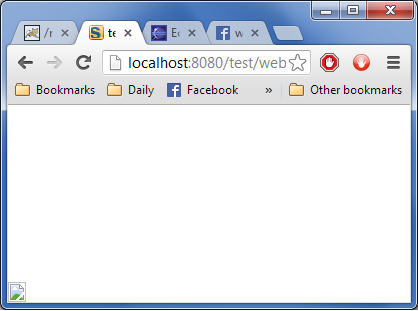

When I point my browser to the /web alias, a login dialog appears which rejects false login/password combos. Once a correct login is entered, it redirects the browser to a broken page (see brokenpage.png attachment).
Viewing the page source, there is the message contained within the HTML:
Quote:Your browser or browser-setup is not supported. <br />Please use one of: IE 7+, Firefox 3.5+, Safari 4+, Google Chrome 7+ or Opera 10+.<br />Ensure that Javascript is enabled and XMLHttpRequests are allowed.
