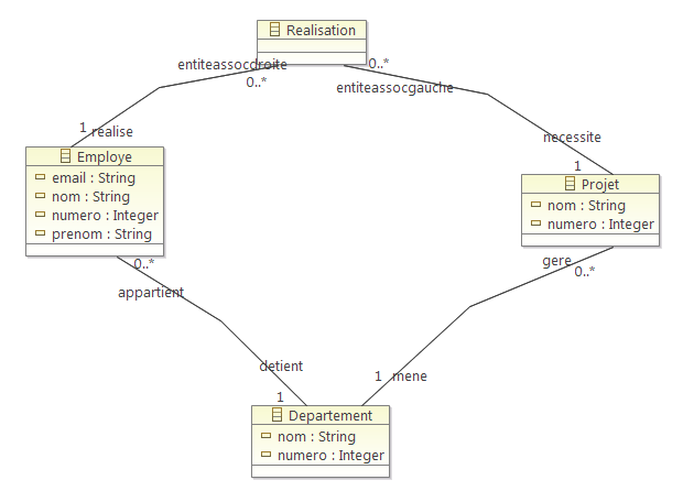

First thanks for your answer. The final goal is to transform OCL into PL-SQL trigger. For that, we are trying to understand how to retrive all informations of a constraint. This is the actual model that we are using for the first version :
[see_attachment_file]
And the OCL code that is passed to the main code :
import 'platform:/resource/OCLToPLSQL/model/projet01.ecore'
package projet01
context Realisation
inv : necessite.mene = realise.detient
endpackage

The main problem I have is how to process the AST. Like you see, on this case, the "=" (must be the root) is not return.
If I try to use the eContrainer() before the while like that :
EObject test = next.eContainer();
System.out.println(test);
The return is simply "null". Have you got an idea to help us on this case ?

On 28/07/2013 00:44, Jérôme Brügger wrote:
> Hi,
> package projet01
> context Realisation
> endpackage
> And the refine code :
> package ch.hearc.ig.ocltoplsql.main;
> public class Main {
> public static void main(String[] args) throws ParserException,
> IOException {
> EPackage.Registry registry = new EPackageRegistryImpl();
> registry.put(Projet01Package.eNS_URI, Projet01Package.eINSTANCE);
> EcoreEnvironmentFactory environmentFactory = new
> EcoreEnvironmentFactory(registry);
> OCL ocl = OCL.newInstance(environmentFactory);
> File file = new
> File("C:/Users/jerome/workspace/OCLToPLSQL/model/projet01.ocl");
> InputStream in = new FileInputStream(file);
> Map<String, Constraint> constraintMap = new HashMap<String,
> Constraint>();
> try {
> OCLInput document = new OCLInput(in);
> List<Constraint> constraints = ocl.parse(document);
> Integer numberConstraint = 0;
> for (Constraint next : constraints) {
> constraintMap.put(next.getName(), next);
> Iterator<EObject> body =
> next.getSpecification().eAllContents();
> while(body.hasNext()) {
> String containBodyConstraint =
> body.next().toString();
> System.out.println(containBodyConstraint);
> numberConstraint++;
> finally {
> in.close();
> And this is the return of the execution of this code :
> self.necessite.mene.=(self.realise.detient)
> org.eclipse.emf.ecore.impl.EGenericTypeImpl@68de462 (expression: Boolean)
> self.necessite.mene
> org.eclipse.emf.ecore.impl.EGenericTypeImpl@4d8ce14a (expression:
> Departement)
> self.necessite
> org.eclipse.emf.ecore.impl.EGenericTypeImpl@5c1ae90c (expression: Projet)
> self
> org.eclipse.emf.ecore.impl.EGenericTypeImpl@6aba4211 (expression:
> Realisation)
> org.eclipse.emf.ecore.impl.EGenericTypeImpl@6a47a0d4 (expression:
> Departement)
> self.realise
> org.eclipse.emf.ecore.impl.EGenericTypeImpl@48ff4cf (expression: Employe)
> self
> org.eclipse.emf.ecore.impl.EGenericTypeImpl@7114460 (expression:
> Realisation)
> self : Realisation
> org.eclipse.emf.ecore.impl.EGenericTypeImpl@7e9ffe3f (expression:
> Realisation)
> case ?
> Regards,
> J.Brügger
