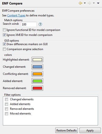

In EMF Compare 1.3 there was a preference option to ignore XMI ID's (see image below), but I cannot find it in EMF Compare 2.1.

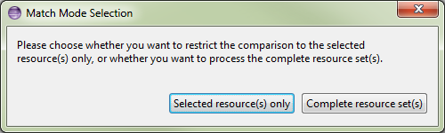

Also our models have references to other models (and thus new reference ID's). Therefor we also compared using 'Complete resource set(s)' (see image below) and this message also disappeard.

There is no preferences available from the EMF Compare UI in 2.1 yet. These are planned for inclusion, but we've focused on the core for now.
As for "resource set" comparison, this is the default for EMF Compare 2. That popup was only there to avoid breaking existing users of EMF Compare 1 by allowing them to fall back to single resource... but that is too bug-prone to be recommanded (since merges could thus break the model integrity). If you were using "complete resource set", then the default behavior of 2.1 will be sufficient for you.
