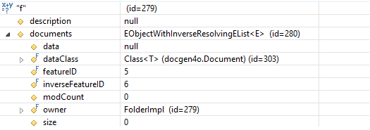

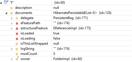

In our application we have this (simplified) model:
- Folder
-- folders : Folder
-- documents : Document
- Document
-- parentFolder : Folder
When everything is loaded the reference 'documents' is a HibernatePersistableEList, but when newly added, it is a EObjectWithInverseResolvingEList.
HibernatePersistableEList:
index.php/fa/15475/0/
EObjectWithInverseResolvingEList:
index.php/fa/15476/0/
Why is this and how can I solve it..?
Re: [Teneo] new eobject reference is EObjectWithInverseResolvingEList [message #1066822 is a reply to message #1066816] Thu, 04 July 2013 10:09 Go to previous messageGo to next message
Hi Ricky,
This is somewhat standard, the way it works, what is the problem or error?
gr. Martin

Re: [Teneo] new eobject reference is EObjectWithInverseResolvingEList [message #1066825 is a reply to message #1066822] Thu, 04 July 2013 10:14 Go to previous messageGo to next message
The problem is that when I import a document (via stored procedure), I try to refresh the folder but the document isn't visible. It works well with an 'old' document.
Re: [Teneo] new eobject reference is EObjectWithInverseResolvingEList [message #1066898 is a reply to message #1066825] Fri, 05 July 2013 01:54 Go to previous messageGo to next message
Hi Ricky,
I would need some more info, in the first post you say newly added document, this is added on the client? And then on
the server you add another and refreshing the folder doesn't help?
What is new and what is old the folder or the document?
gr. Martin

Re: [Teneo] new eobject reference is EObjectWithInverseResolvingEList [message #1066919 is a reply to message #1066898] Fri, 05 July 2013 03:18 Go to previous messageGo to next message
Ok, this is the begin data:
- ROOTFOLDER
-- SUBFOLDER1
The client imports a document in 'SUBFOLDER1'. This is done via a stored procedure. This procedure adds a document in the database. When I call hibernatesession.refresh(SUBFOLDER) the structure is like this:
- ROOTFOLDER
-- SUBFOLDER1
--- IMPORTEDDOCUMENT1
Then the clients creates a new folder (via AddCommand in editing domain). This gets saved and the folder is stored in the database. The structure looks like this:
- ROOTFOLDER
-- SUBFOLDER1
-- SUBFOLDER2
When the clients imports a document in 'SUBFOLDER2', the document is added in the database but it isn't visible when I call refresh(SUBFOLDER2).
I think it is because of the documents feature is a 'EObjectWithInverseResolvingEList'....
[Updated on: Fri, 05 July 2013 03:19] by Moderator
Re: [Teneo] new eobject reference is EObjectWithInverseResolvingEList [message #1067282 is a reply to message #1066919] Mon, 08 July 2013 04:01 Go to previous messageGo to next message
Hi Ricky,
Strange the difference in behavior between subfolder1 and subfolder2. Normally when creating and saving a record then
its collections should also be replaced by a hibernate elist...
Can you enter a bugzilla for this? Sorry to say I am a bit overloaded with work at the moment. But feel free to ping me
often on this, it really helps...
gr. Martin
