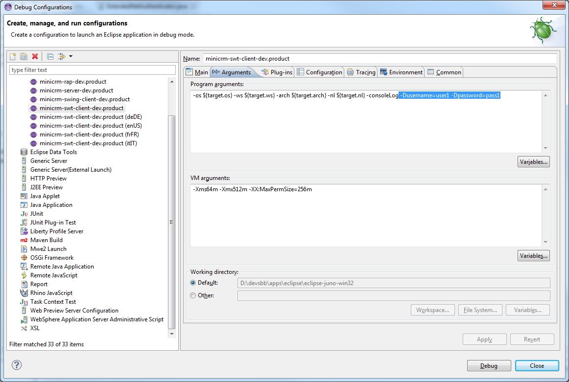

Thanks for your answer, however it does not seem to work:
I have added the following to my run configuration:
 -Dusername=user1 -Dpassword=pass1
index.php/fa/15499/0/

  • Attachment: config.png
    (Size: 131.39KB, Downloaded 599 times)

Just put your arguments as "VM arguments" instead of "Program arguments" and it will work.
I am not sure how the arguments that are defined in "Program argument" are handled in eclipse. In a JavaSE project those will be passed to the main(String[]) method.

Thanks Jeremie
When I put my arguments into "VM arguments" instead of the program arguments I can indeed access them the way you described. However, this seems a bit like a hack.
I realise that program arguments are passed to the string array in main(), I thought that maybe the client would make these parameters available to the client plugins in some way. I take it, that this is not the case? Ideally I am looking for a way to get access to all arguments passed to main() without having to know their names from within the client and renderer plugins.
