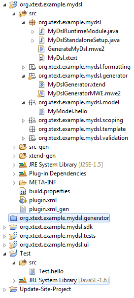

Christian I m sorry but I cannot understand what you mean. I have attached a snapshot of my project structure to explain you what I mean.
The org.xtext.example.mydsl.xxx projects are the xtext projects which I used to create my dsl and run my xtend generator.
The Test project is the one I create to test my dsl. I have added a new file Test.hello with my model( .hello is the extension of my dsl). And now I want to generate the code for the Test.hello file
1) what do you mean by "default setup"?
2) Which one is the "pregenerated generator"? Is it the one in my intial xtext project (org.xtext.example.mydsl.mydsl? The MyDslGeneratorMWE.mwe2 ?
3) What do you mean by "build automatically on the generator"? Which generator are you referring to ?
Thank you for your for your support
